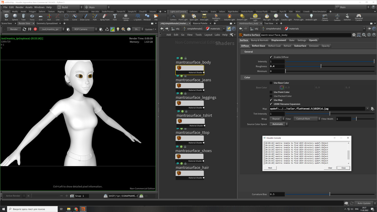

Good day!

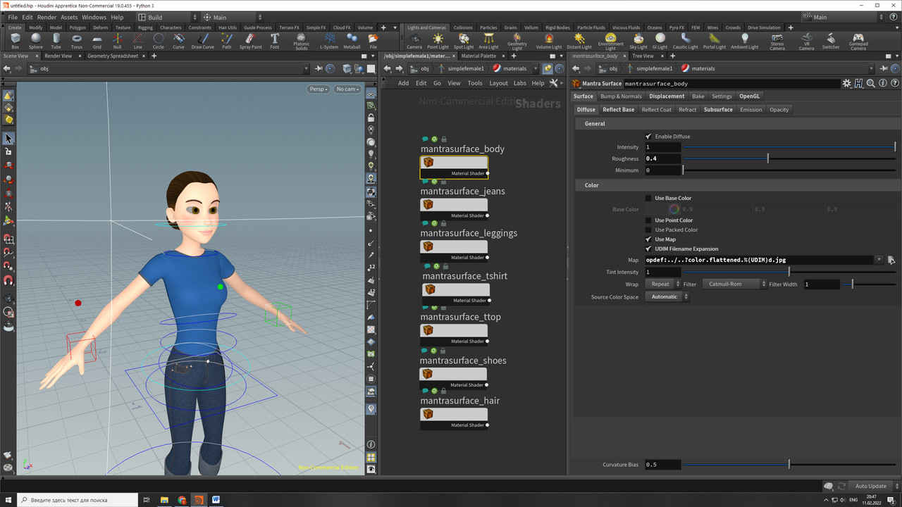

I remember for sure that somewhere at the beginning of 2021 there was no such problem. Then it appeared in subsequent versions.
The bottom line is that the basic character "Simple Female" is displayed in the viewport with textures, but only the eyes remain colored on the render. The console displays the message: "mantra: Unable to find UDIM directory opdef:/Object".
I tried to find these textures to point the way to them, but I didn't find them.
Could you tell me how to fix it?

looks like you discovered UDIMs from opdef textures are broken. Bug it up
Thanks for the answer, but I didn't understand what needs to be done.
I didn't do anything with the character. I didn't make any settings. Exactly the same problem with "Simple Male".
But with "Tommy" or a "Rubber Toy", everything is fine
Could you try it for yourself? Is this a factory error?
Thanks in advance!
There's nothing to be done other than report the error to Sidefx.
https://www.sidefx.com/bugs/submit/ [www.sidefx.com]
It's working in 18.5 if you have access to an older client.

I contacted technical support and I am surprised that the problem was solved in 7 days! The bug has been fixed in version 19.0.534.
