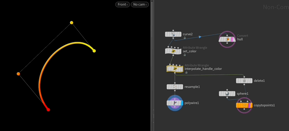

@antc
That almost works! Although the idea is to have access to this sampling straight forward.
I changed the position of the Bezier CPs and made Cd.x into @width for polyframe. In the image, top your setup, bottom what I'm going for here with, linearly sampling along the curve's length. Admittedly I had to fix the first post's file to depict that accurately.
Thanks
Edited by probiner - May 29, 2022 15:54:50
