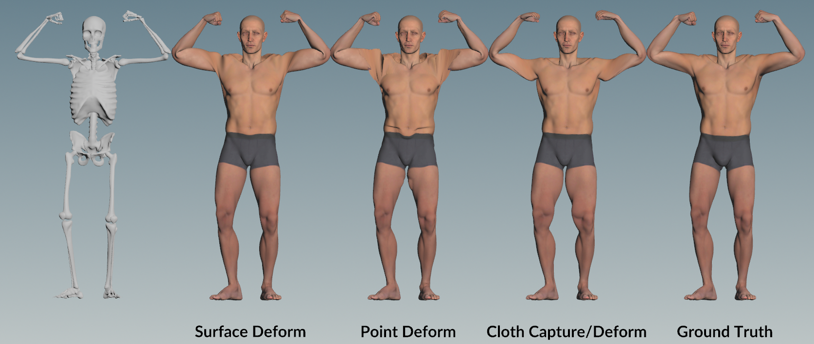

Resurrecting this old thread to remind people of the existence of the Surface Deform SOP, which has been available since H20, but slipped beneath the radar a bit it seems. It uses
Some other cool features it has:
- ability to treat the deforming surface as a subdivision surface, resulting in a smoother deformation
- option to specify a piece attribute
- ability to split the capture and deform steps into separate nodes if preferred
And we have also added, as of 21.0.591, the ability to smooth the influence of the deformation over nearby points with new Blur parameters, which is especially useful the bigger the shape disparity of the input and rest deformer meshes.
As you can see in the attached image, in even the pretty extreme case of using Otto's anatomical bones to deform his skin, the Surface Deform (with the new blur functionality) works much better than either the Point Deform or the Cloth Capture and Deform. Though it is obviously no replacement for proper boneCapture weights (Ground Truth in the image).
primuv()and xyzdist()internally, so it allows the nearest surface position of the deforming surface to deform points, which means is much better suited to the task of driving high res meshes with low res meshes, sim meshes with render meshes, etc than the Point Deform SOP.Some other cool features it has:
