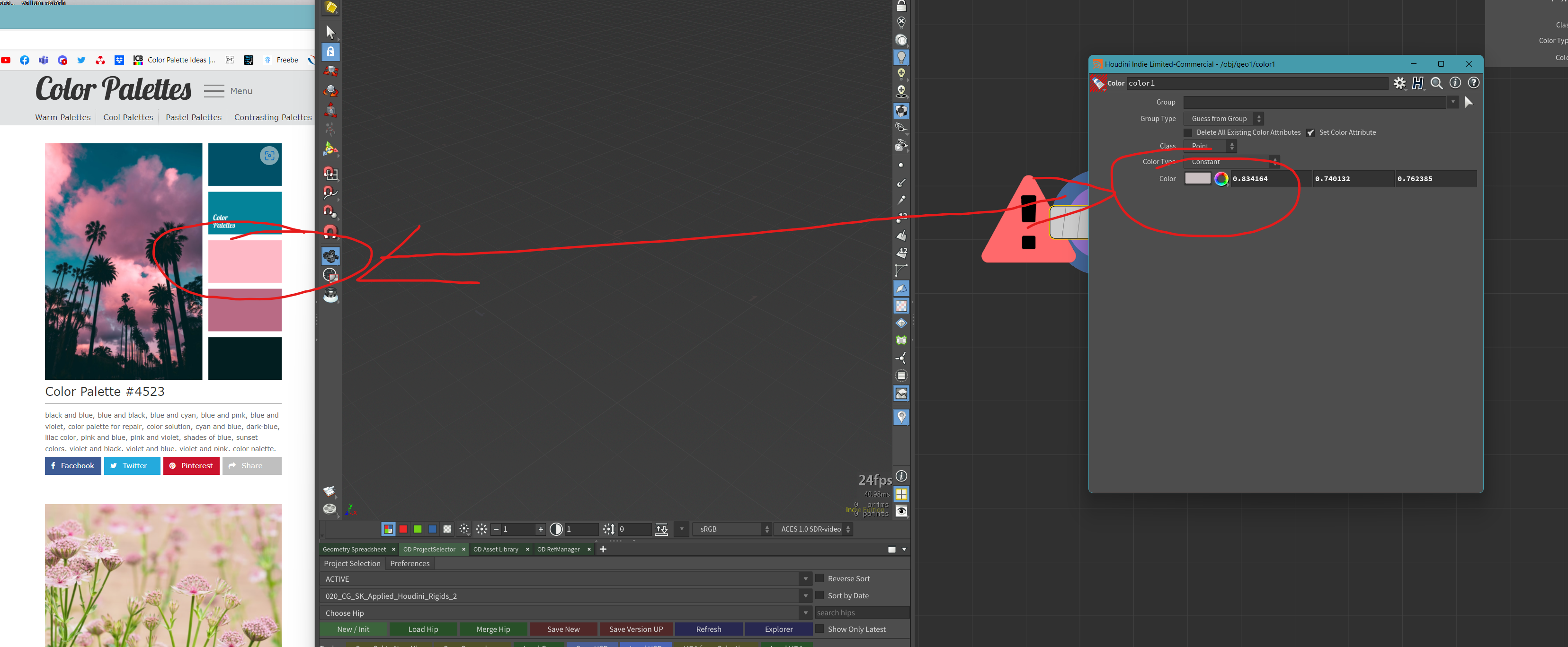

When I middle click to sample an image outside houdini, colors are not converted to ACES
To have correct color I use the RGB code of the source color then I transform it into ACES with this site https://acescolorspace.com/rgb# [acescolorspace.com] and then I copy/paste the values in he color sop
Is there a fatest way to do that ?
Thanks

On the color picker, make sure you have color correction enabled. It's the sloping icon on the right.
it's checked
it's checked
That thing doesn't work at all. It seems like it applies the forward gamma conversion no matter what direction the picker is going in. I end up with a value that's double or triple gamma corrected instead of the inversed linear value. I did, however, figure out how to at least pick colors without any correction so that it can be converted in Houdini using ocio convert nodes. Disable the color correction 'gamma icon' on the color picker, then set the picker space to 'ignore colorspace'. this will allow picking screen colors as-is, but they still need to be converted to linear or acescg.
I usually read the image in COPs and use ocio transform nodes to convert from the input space to ACES, then read the values off the viewer with the inspector mode.
