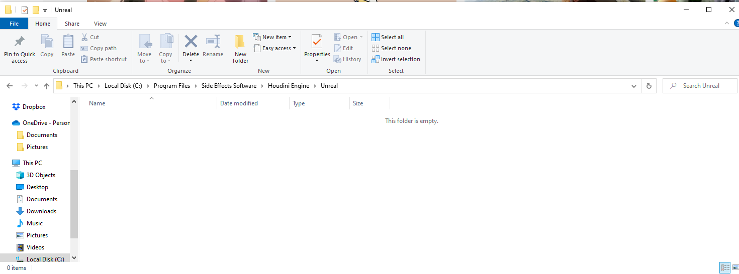

Hey Im having trouble installing the new version from the Houdini Launcher which normally works totally fine for me.
Attached are the set of errors I get in order of them coming up from a new install. One of the errors states the Unreal Plugin is already installed but screenshot 4 shows nothing there. Launching does nothing or presents the error message in the last picture and repairing also doesn't fix the issue.
