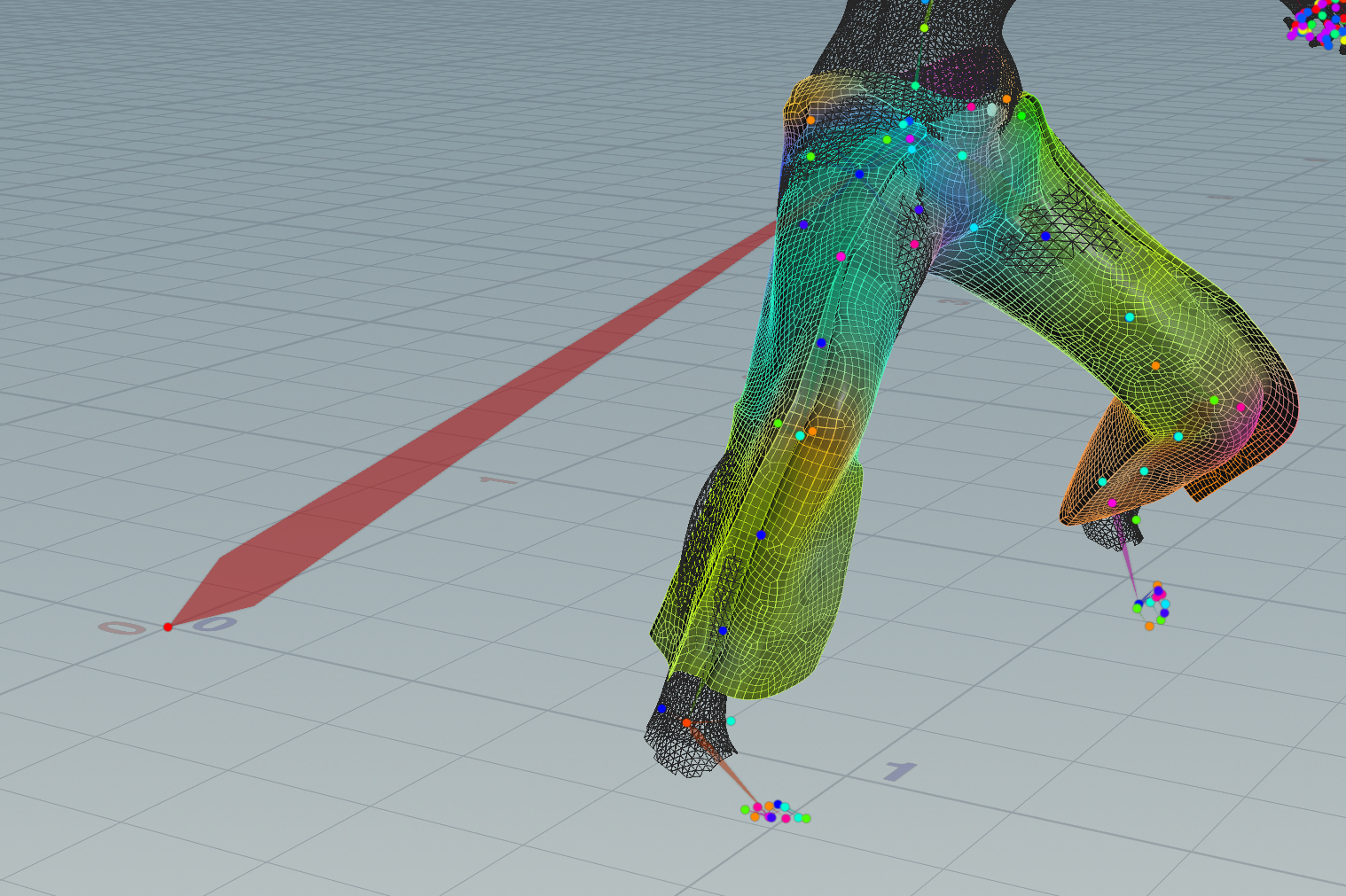

Thanks for the replies. I've seen a Brundlethwaite tutorial on Modifying Weight Data post capture, but that was a lot for what I was hoping could be a pre capture edit. I asked this same question on the cgwiki discord, and Matt Estela kindly responded with some tips for how I could approach modifying pre + post capture data for my use case.
The one I went with was using a group selection in the Bone Capture Lines. This group selection excluded the root, while including only the joints in the leg/hip area. This worked great for me since I only needed the leg + hip area joints influencing the capture since I'm trying to skin weight pants to a rig.
Hope this thread helps anyone else looking to do the same thing(s).
