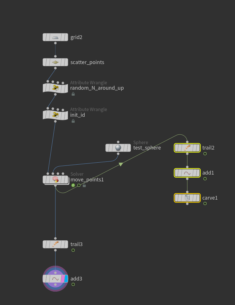

I've almost got it working with a solver.
When I use xyzdist function and have just some standard geometry connected to input 2(1) I get the results Im after.
My trouble is that I need the trails generated by the particles to be what they collide with.
If I try connect the geometry generated by the trails they collide/stop straight away. hmmm

I've figured it out thanks to a tutorial by Junichiro Horikawa.
Ended up using a recursive setup with a for each loop.
