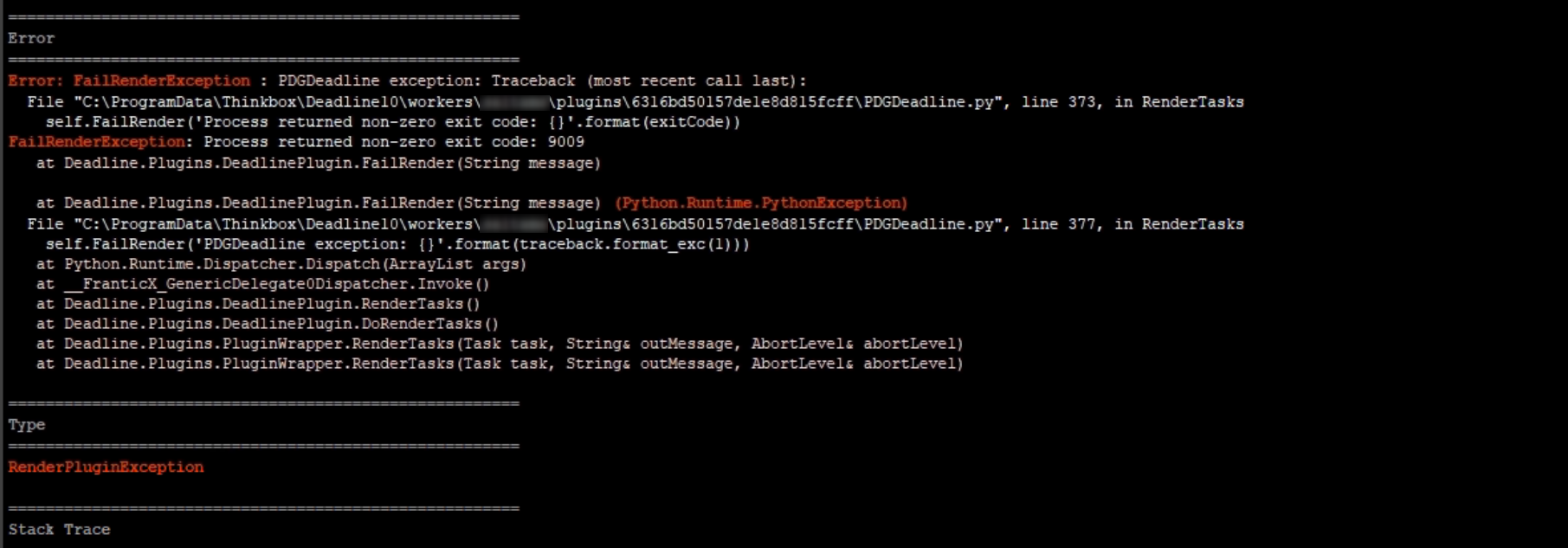

Will a JOB submitted in DeadlineScheduler from USD RENDER TOP work?
When I use USD RENDER TOP in Houdini 19.5.361 and throw a job with DeadlineScheduler, I get an error like the attached image. if I use LocaleScheduler with LOCAL MACHINE, it works fine.
The version of deadline is 10.1.21.4.
The version of windows is 10.
Please confirm.
Submit USD RENDER TOP in DeadlineScheduler

I'm assuming that it's because of you set Python 3.7 for Deadline Submission.
You may take a look at this.
Houdini 19.5 - make Deadline work
https://www.youtube.com/watch?v=UmQ9TflX4wU [www.youtube.com]
