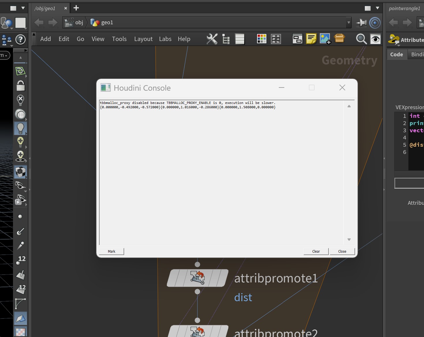

Hi how to change the font size of text in Houdini Console without affecting the rest of UI. the stuff that I printf in Vex are in tiny font and not readable. Also can I text wrap in the Wrangle vex editor? Thanks

It looks like Houdini is just using a standard OS Window. Please check your regular OS settings.

Has anyone figured out how to change the console's font size? Edit: Starting Houdini from CLI directs all log messages to the console and gives full control over all aspects of how the logs are displayed.
