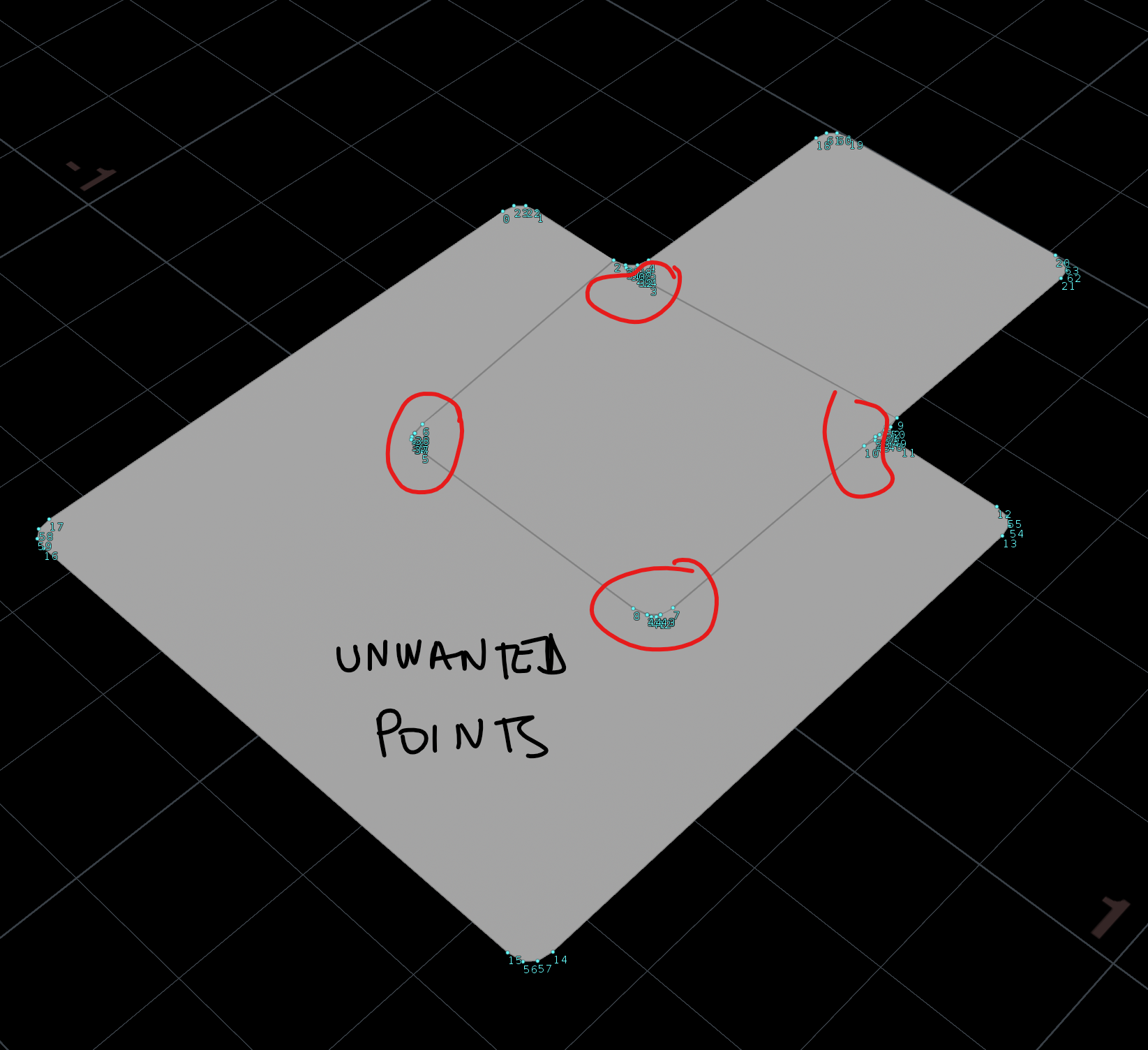

Have encountered a problem when trying to boolean two surfaces (overlapping grids).
Ideally I'd like to have a clean surface which I can further model downstream, but it's unusable after the Boolean SOP.
Take a look at the attached HIP and screenshot.
Any help would be much appreciated.
Cheers

You can use a Labs dissolve flat edges after the boolen to remove the unwanted edges.
Cheers

Exactly what I wanted, thanks so much CYTE for the quick and correct answer.

You can also use Divide SOP and check Remove Shared Edges

Thanks a lot Tomas, works similarly to the Dissolve Flat Edges and is native to Houdini, learning something new everyday in the abundantly rich world of Houdini.
