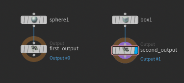

This is what I'm doing in the test:
- setting outputs to polygon mesh sphere and box (1. screenshot),

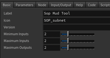

- Max outputs set to 2 (2. screenshot),

- sync, reload in Maya -> get only the first output in Maya. Switching which one is first simply outputs the other one that is then first. See how the hierarchy looks in Maya (4. screenshot).
I tried to reopen both Maya and Houdini, reload, reimport the HDA in case it wasn't loading the correct definition, but no matter how many outputs I set, I always get out just the object that is linked to the first output (#0 output), even if I switch which one is linked in.

This is a current limitation with the Houdini Engine for Maya plugin. To get around this, you can create a group per object and then enable the "Split Geos By Group" option in Maya.
