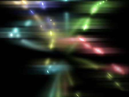

Heh! Yeah, cool, that gets the look for sure. Thanks for taking the time to put that together for me, I appreciate it.
The only problem was that it took ages to calculate an image like the one below - too many frames I guess! So I'm still interested to know if it's possible to do the post-frame script thingy if anyone has any ideas.
Andy
Andy
