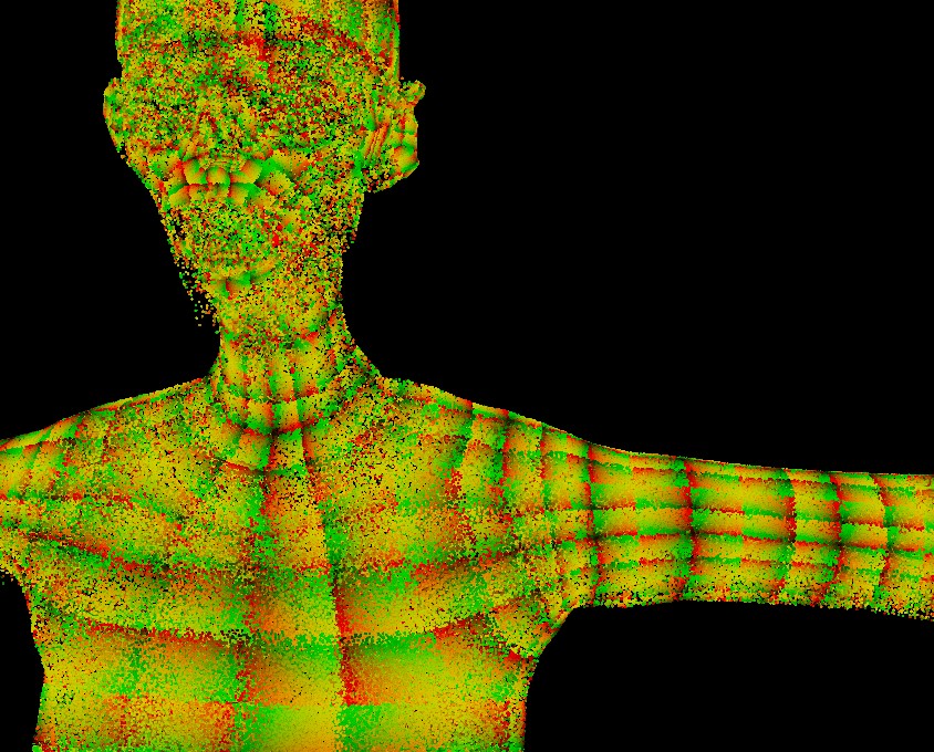

Hello, I created a particle simulation to make a dancing character rise with particles coming from the floor - think of it as a reversed dissolve effect.
Now to blend the particles to the final mesh I need the particle to get the color of the closest position in the mesh's texture. I guess I can't just use Attribute Transfer here, as it only takes the values stored in the geometry and not the map itself. So want the particles to get interpolated UVs instead.
This is the network I have to reach that so far.
This is how I expected to get interpolated UVs:
int prim;
vector target=minpos(1,@P);
xyzdist(1,target,prim,@uv);
But for some reason xyzdist() doesn't work as I thaught. Instead it projects every single face of the mesh to a full UDIMM and uses these projections to calculate uv. Here I visualized the resulting uv:
Can you tell me what I got wrong here? And how do I receive correct uv?
Hope you can give me a hint, thanks a lot!

after xyzdist, use primuv() to look up the attribute uv using the parametric uvw retrieved by xyzdist.
float d;
vector hitprimuv;
int hitprim;
d = xyzdist(geo, origin, hitprim, hitprimuv);
vector uv = primuv(geo, "uv", hitprim, hitprimuv);
edit:
you can also use the attribute interpolate sop to do the primuv() step.
Edited by jsmack - March 21, 2023 14:46:15

Alternatively you can also use Ray SOP directly
Method: Minimum Distance
Transform Points: Off (if you don't want them to move)
Import Attributes From Hits: On
Point Attributes:
Vertex Attributes: uv

Thank you very much! All ways work great here.
