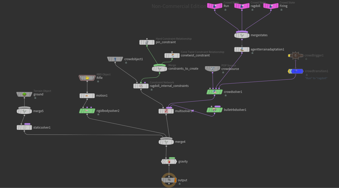

I'm trying to automate the process of firing a rifle. I've got a rifle set up to emit a muzzle flash, and I'd like to sync that up with the rifle kicking back against the figure holding it. My current setup involves the rifle feeding into a DOP network (image 1) with a Motion DOP set to a Z velocity of -2 with activation of $F%20==0, so it "kicks back" every 20 frames. That part works just fine, but I'm having trouble with the procedural animation. My figure (image 2) is an agent with an animated rifle-holding idle, set up with ragdoll constraints, the rifle imported from the DOP and captured as packed geometry. This is fed into a second DOP network (image 3) where the ragdoll is solved. It seems like capturing the rifle voids the Motion DOP. This wouldn't be a problem if I could figure out how to bring the captured rifle into a DOP network and apply the motion there, but I haven't been able to do that. I suspect that I'm going to have to familiarize myself more with working in CHOPs, but I'm open to any suggestions you might have.
