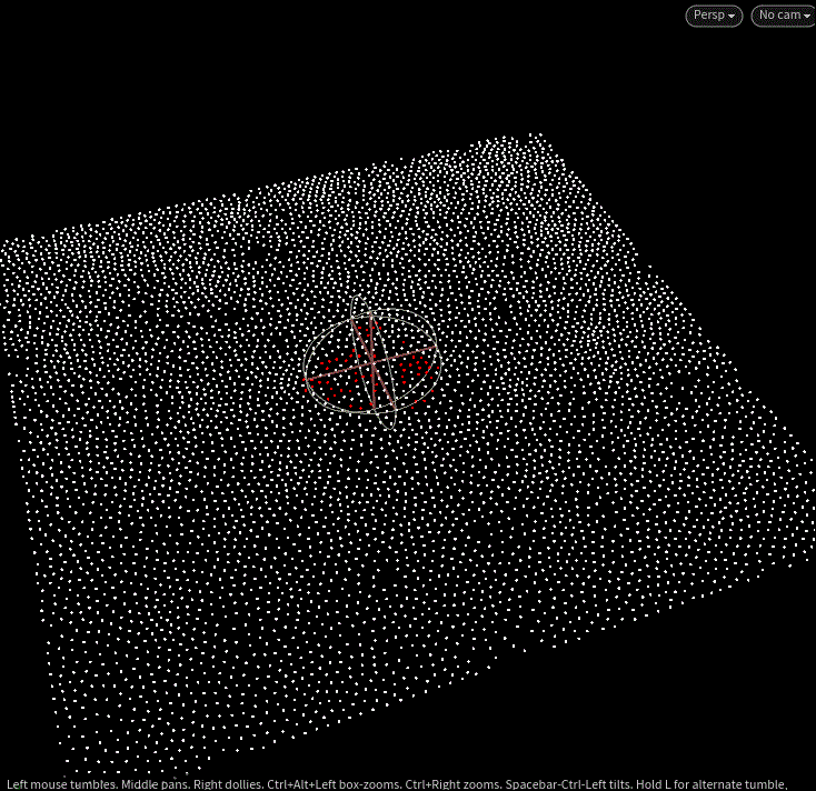

Just a simple infection solver; but I'm trying to reset the "infect" attribute so my grid of points can be infected again. I'm using age attribute to set infectioin to 0 after certain frame. But i need it to feed it back in. How can i do this?

You have to reset @age at some point, otherwise the @age>15 condition will remain true.
Yup, you're right. I probably need a coffee.
Just had to add if(@infect==0)@age=0
