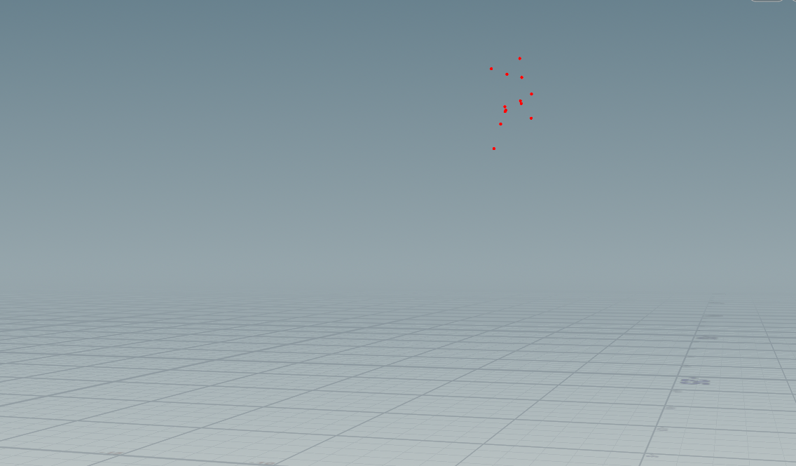

Hello,
I am trying to export a particle simulation to USD. The effect starts with 0 particles and ends with 0 particles. USD doesn't seem to like this. When using the USD export sop and reading the file with USD import, you can see the issue. It seems like it won't allow there to be frames with 0 particles. If you look at the video I have the firework effect on the left side, and the usd exported version on the right side. On the first frame (also shown in a photo) the usd version holds the first frame where the particles first exist and the last frame holds the last frame where a particle exists (also shown in a photo). It seems like there cannot be frames where no particle exists so it finds the closest frame where a particle does exist. I don't have this issue when exporting to a USD sequence, but I need to get this working in one USD file.
Any thoughts?
Thanks,
Evan

The problem is when you have no particles there is nothing for USD to create, so it won't create an empty points primitive.
Before exporting your particles, add an "Add" SOP and enable "Particles" > "Add Particle System"

Actually still having trouble.
the first issue is that I was separating my particles with a name attribute so they would show up as separate primitives in solaris. The particle system breaks that.
Also I still get warnings/glitches (like the frame when the particles should not exist it still shows them and give a warning. if I refresh the render the particles do go away but I still get the warning).
maybe I should just add a point (out of camera) that stays throughout the whole shot to avoid this issue.

The reason using a single Add SOP with a particle system isn't working as you'd expect is it creates a single points primitive - when there are no points, it'll create an empty points prim and when simply adding points to the particle system, everything works as expected - you have an empty points prim that slowly fills up with points.
However, as soon as you have points with their own path or name attribute, this will take precedence over the particle system's path or name, and they'll create their own points prims. So you're back to your initial problem. The particles stick in space because as you're aggregating all the USD data, it only creates the points prims once you have particles so the first time sample it'll create (and hold for frames before that) already has points.
You'll need to create as many empty particle systems as there are unique names or paths in your points, and give them the appropriate name/path attributes.
Same goes for empty mesh prims.
Here's an example file - dive inside the sopnet for more details.
EmptyPoints.hip (99.3 KB)
