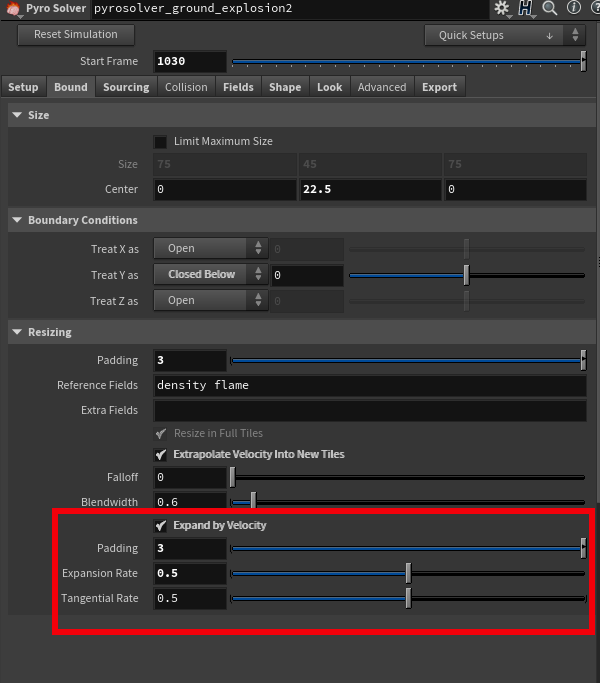

using a groundplane for ground collision instead of the y-bounds on the smoke object seemed to fix it for me in case anyone else struggles with the same problem and finds this thread
11 posts
Joined: Oct. 2018
you need to check those parameters
