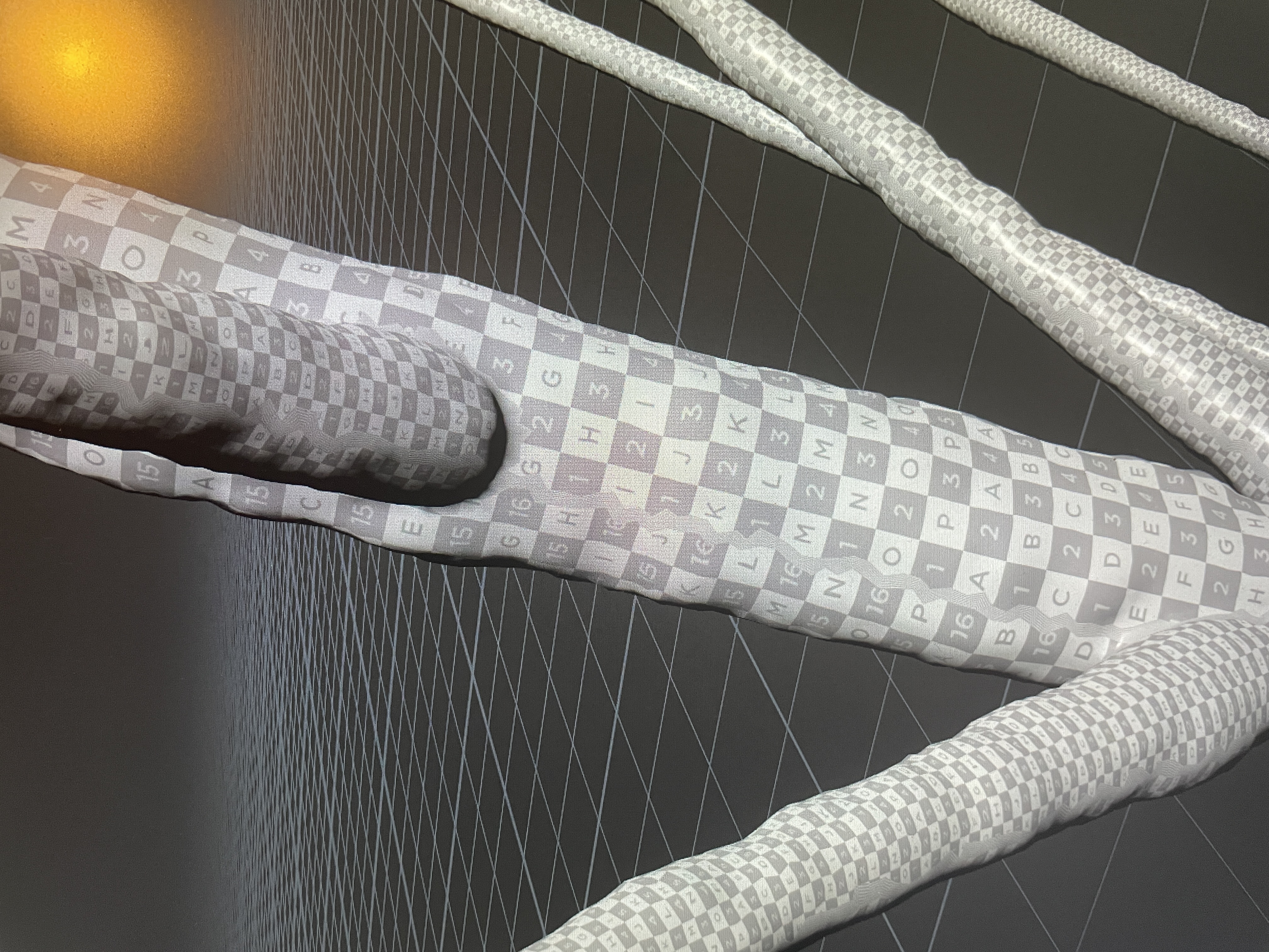

Hello,
I have dig the entire web for the beginning of an answer but couldn’t get anywhere.
I am trying to transfer UVs from a plant to a similar high poly bigger one made with VDB and converted back to poly.
I am using xyzdist() and primuv().
I still have some distortion and issues. See pictures.
What am I doing wrong?!!
Cheers,
Anbt
Edited by anbt - Sept. 7, 2023 14:50:38
803 posts
Have you tried using attribute transfer set to vertex and attribute uv?
Cheers
CYTE
82 posts
Joined: Dec. 2020
CYTE
yes, I tried, it is even worse
Edited by anbt - Sept. 7, 2023 15:11:23
82 posts
Joined: Dec. 2020
and the labs UV transfer also doesn't output good results
294 posts
Joined: July 2013
it's not working because the UV seams will not match. So if you want to transfer you'll need to keep all the points/verts that are in the UV seams which will add quite a lot of extra polygons. Plan B would be to transfer the texture by baking, There are a few tools for that in labs. Google "houdini uv baking transfer texture" for more clues
More code, less clicks.
82 posts
Joined: Dec. 2020
Jonathan de Blok
OK, I wouldn't know how to do plan A but plan B seems easier. Will investigate, thanks
504 posts
can you post an example file, where labs uv transfer fails?
82 posts
Joined: Dec. 2020
Aizatulin
Will do when I am back in front of Houdini
