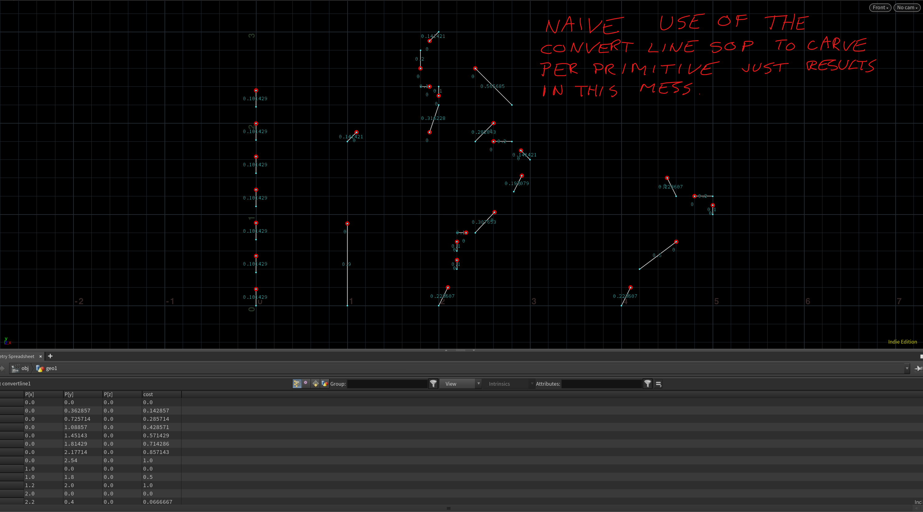

@BabaJ - yes, I am carving poly lines. You can see from the attached images what the difference is between my custom carve and the carve sop. I am not sure about what you mean when you say to apply the carve node per prim as needed. This just results in a bunch of separate, free floating primitives, which is not what I want. To build something around this in order to mitigate that behaviour would surely negate the slight performance advantage the carve node has, right?
So, can I then assume that getting the desired behaviour, that you can see in the custom vex carve, is not possible with the carve sop?

What I was showing you is but one step if you wanted to use the carve sop.(I thought you would be able to see the other steps).
Just calculate your total distance for the entire segment, get the ratios of each individual segment per total length, which will let you know what 'uv' distance each segment is. From there you can carve(with the sop)the specific segment in which your target uv is lying.
Did you try comparing a single segment with vex(only two point ends) compared to the carve sop?
To build something around this in order to mitigate that behaviour would surely negate the slight performance advantage the carve node has, right?How do you know the carve sop has better performance when it's not doing what you have with vex?
