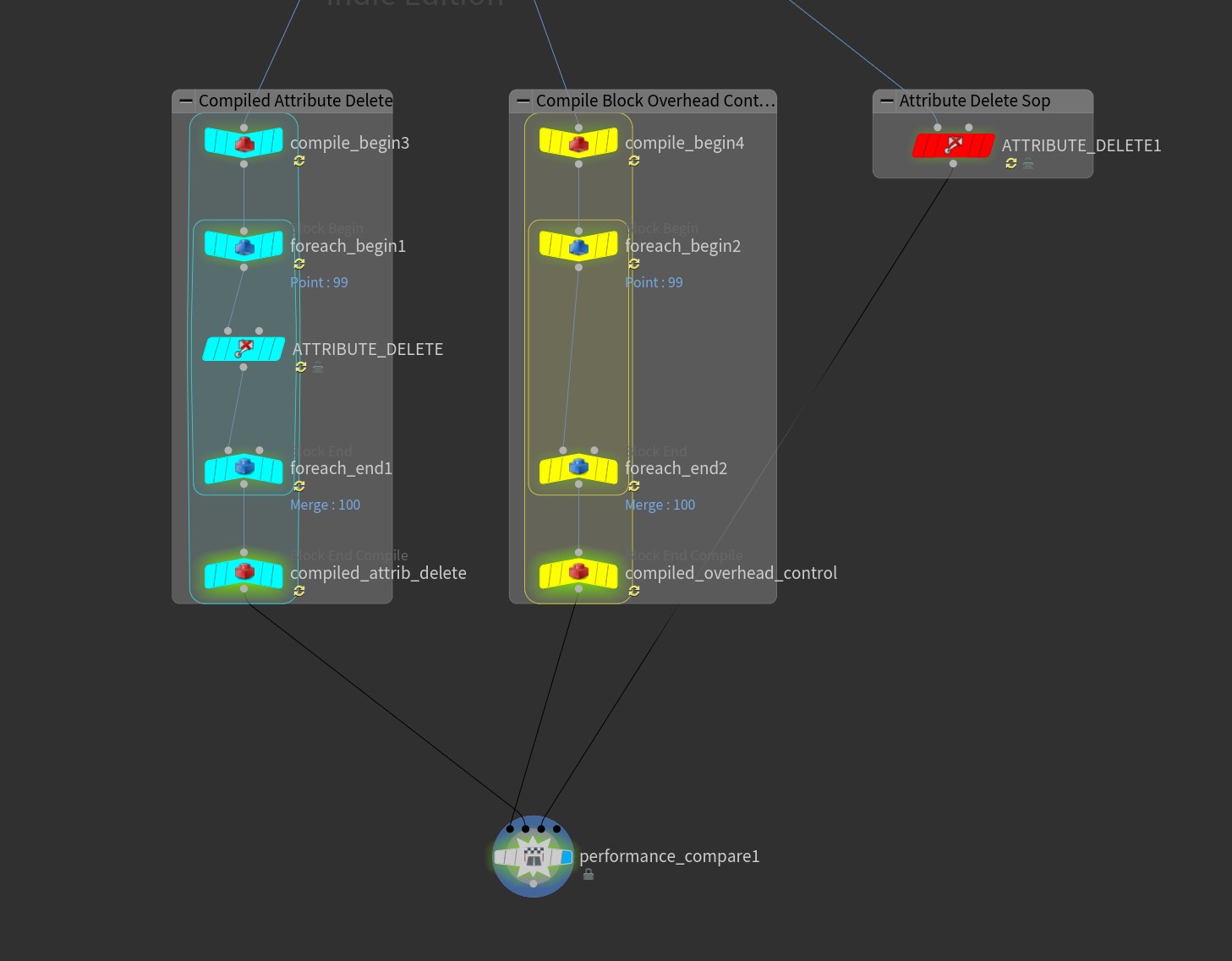

I've conducted some profiling, but there are a couple of important points to note:
Testing Scenario:
HOW TO READ THE CHART:
As mentioned, you should compare the timing difference between the two compile blocks and measure it against the timing of the Attribute Sop.
As you can see, not only does the Attribute Delete Sop appear to be faster when outside the compile block, but it also doesn't experience an increase in cook time as the number of attributes for deletion increases.
Also to note: the Compiled Attrib Delete cooking time grows even faster than the Empty Compiled Block.
- I'm not really sure how to setup the testing scenario: I guess that, for a fair comparison, we should exclude the Compile Block Overhead. The assumption here is that in the scene a compile block already exists, so we should not really take it in account when making the comparison.
Then, to measure the actual cooking time of the bare Attribute Sop inside a Compile Block, we also measure the timing of an empty compiled block and calculate the difference between the two.
You tell me if this is the correct approach. - I used a profiler in its early stages of development, which has undergone very little beta testing so far, I wouldn't be surprised if it produced wrong results. I've attached an hip file with the testing scenario so you can validate the setup and the results yourself.
Testing Scenario:
- 500k points divided into 100 clusters for iteration.
- 10 profiling sessions, with an increasing number of attributes to be deleted in each session, ranging from 1 to 20.
- each session was repeated 5 times and its timings averaged
Edited by Andr - Oct. 9, 2023 06:21:18

@animatrix and @Andr
I know that it's been a few days since I posted the question, but still thank you very much for your answers! The above graph is quite clear I think. However where I would have placed the attribute delete node would have been more like in the attached image, namely after the foreach loop, but still inside the compile loop. I just did a quick test, and it seems that this is faster than the left example in your image, but still slower than the attribute delete entirely outside of the compile loop.
Thanks again,
Dag
