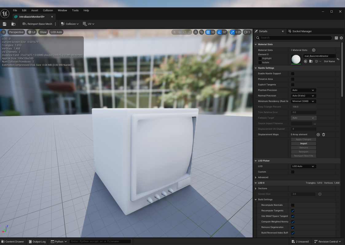

This results in a FBX model being imported, and since I asked the UE5 importer to create materials, the material does exist, but it has one blank base texture assigned to it.

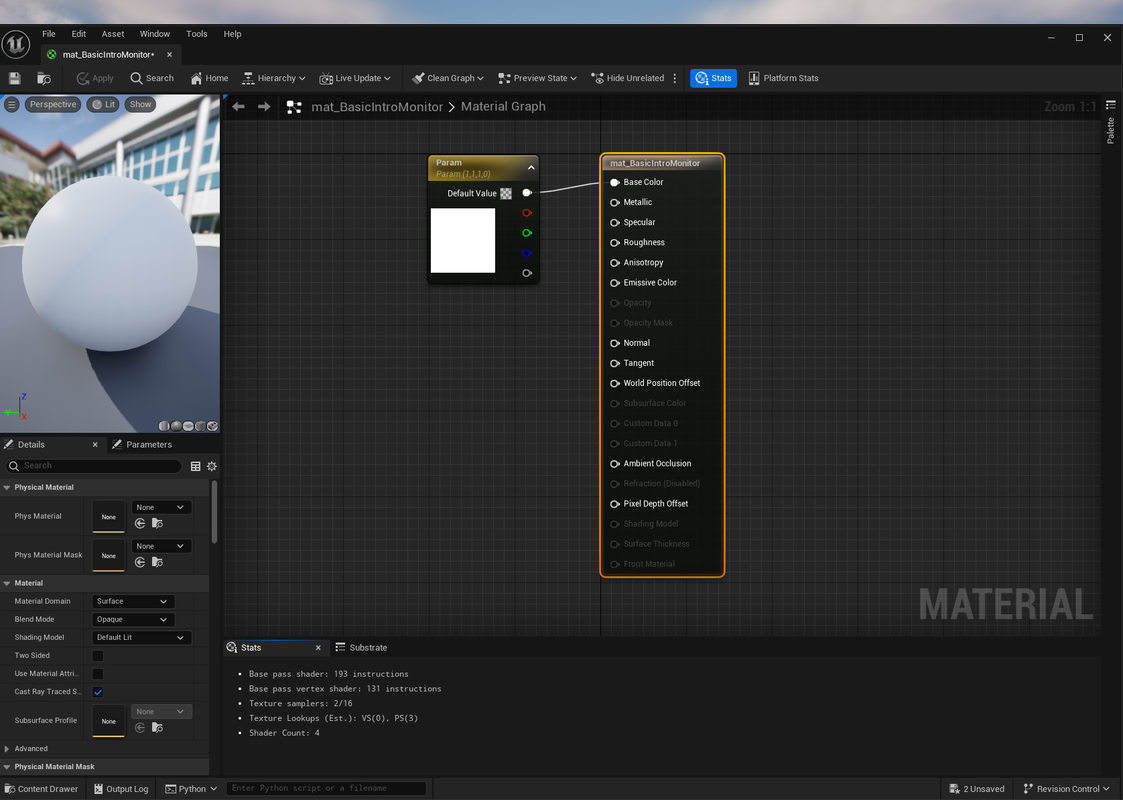

Could I wire it up in UE5 myself? Sure, but I also have to import the UDIM/Virtual Textures as well. I could automate this (looking into that now), but it bothers me that the Houdini FX 'tokens' used to specify materials that works in Houdini doesn't translate into UE5 at all.

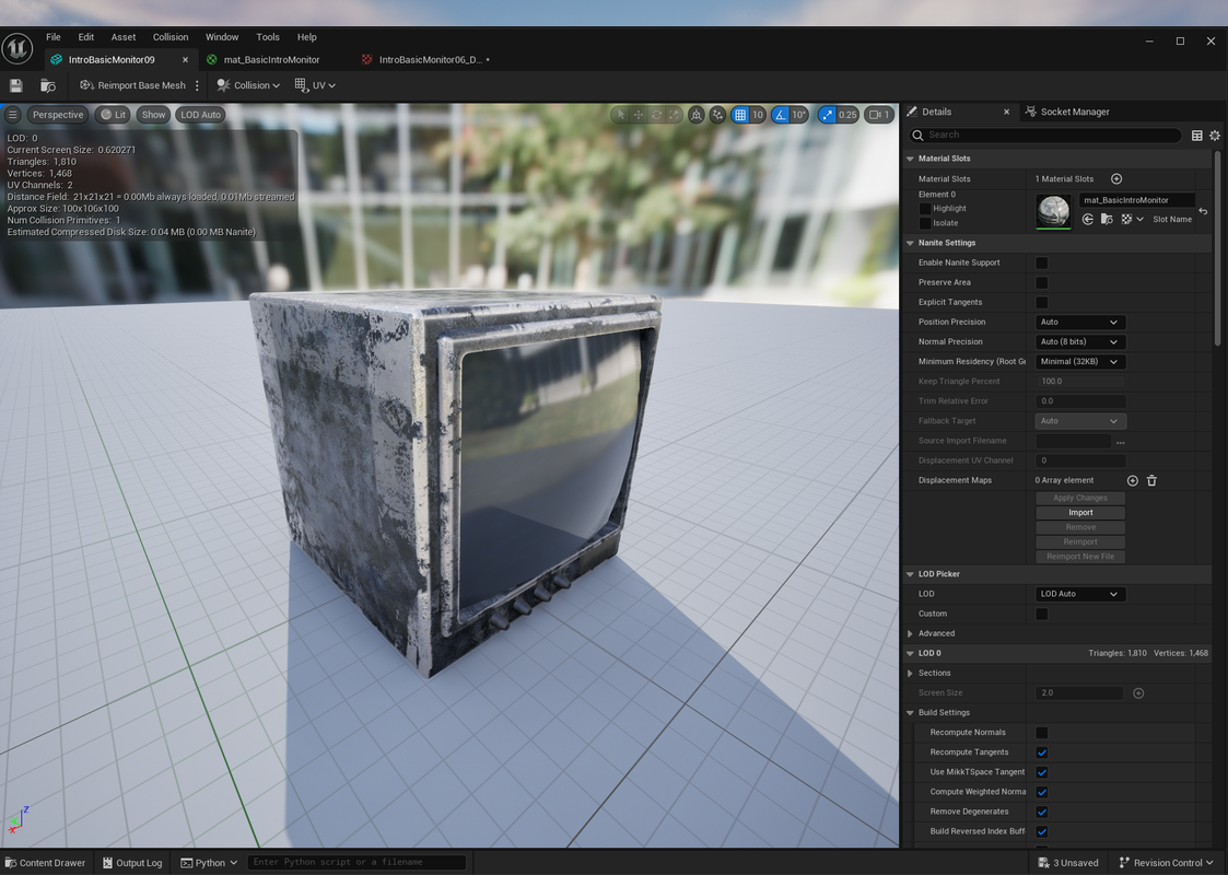

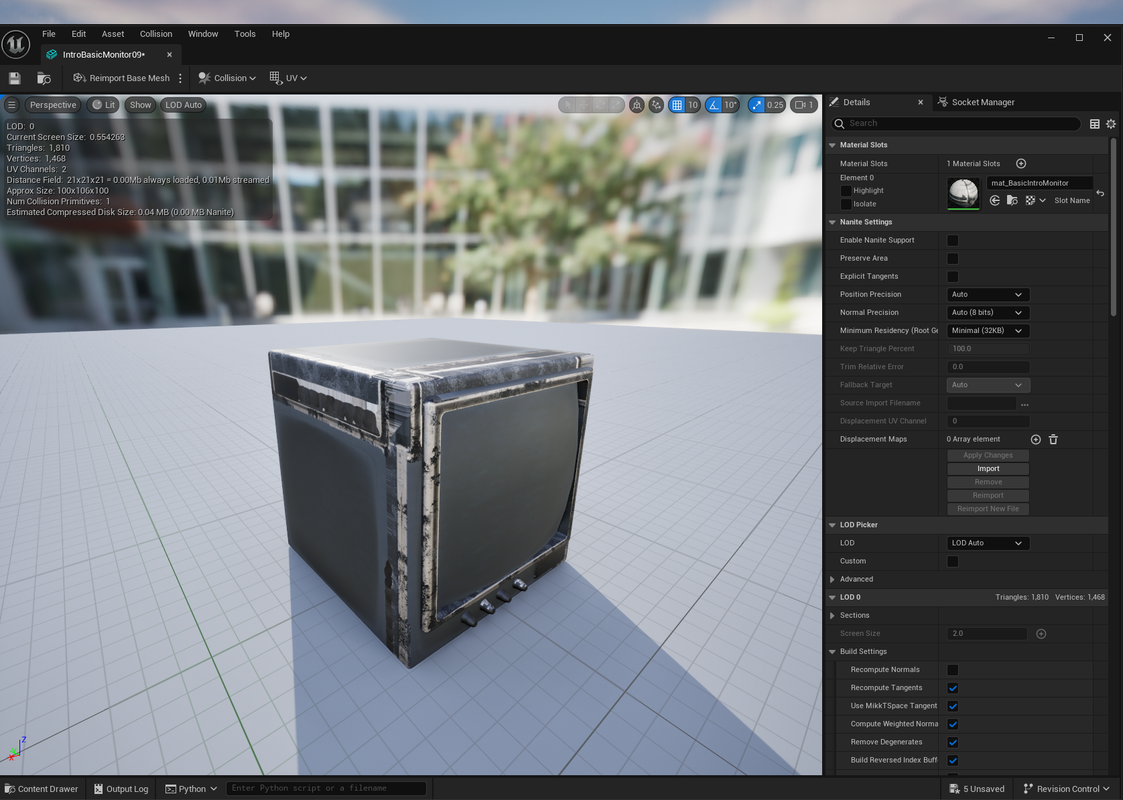

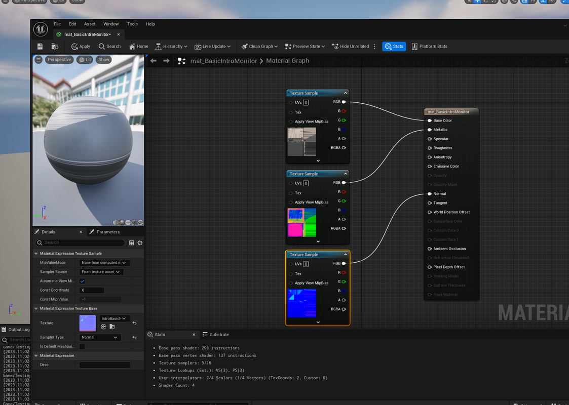

Here's the pics where I manually imported the UDIM/Virtual Texures and wired up the material myself:
Just wondering if there's anyone out there that has actually done FBX export with UDIMs and made it work. Just importing the file generated by Houdini FX, nothing else.
