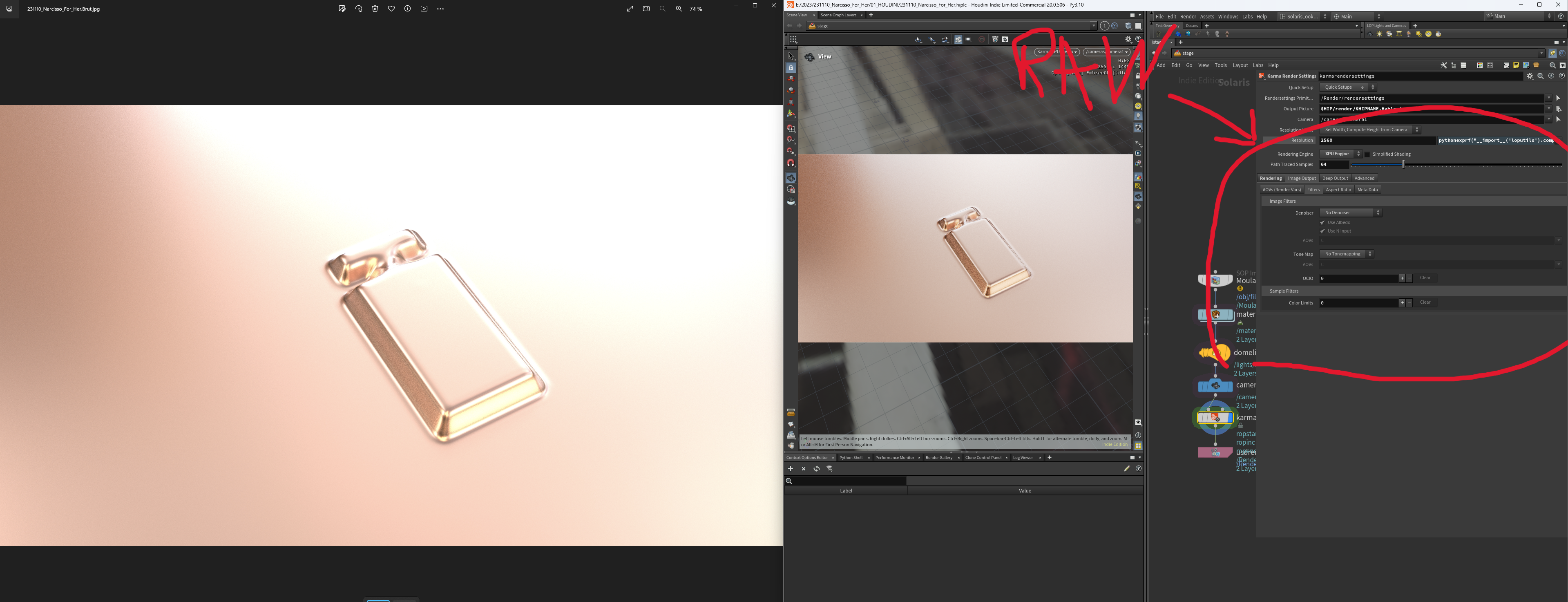

Very excited by Houdini 20, I try to switch my workflow from blender to Houdini (except for modeling ).
But I have a problem :
I often need to make "small" jpg exports for my clients, before moving on to the post-production stage (where I work exr to have more possibilities).
I work in aces, and the problem is that when I render from karma, the the opencolor display/View does not apply and I don't know how to do it.
- I did a "raw" test which clearly illustrates the problem
- A test with the Hable tone map in the KarmaRenderSetting (this is the tonemap that is closest to what I have in the viewport)
- The only method I found to have EXACTLY the same rendering as the viewport is by using "render to mplay" and when I do "save frame as", in colorspace I use "bake to opencolorio Display/ View".
Is it possible to use this option WITHOUT going through "render to mplay", because to do lots of rendering, it wastes a lot of time
