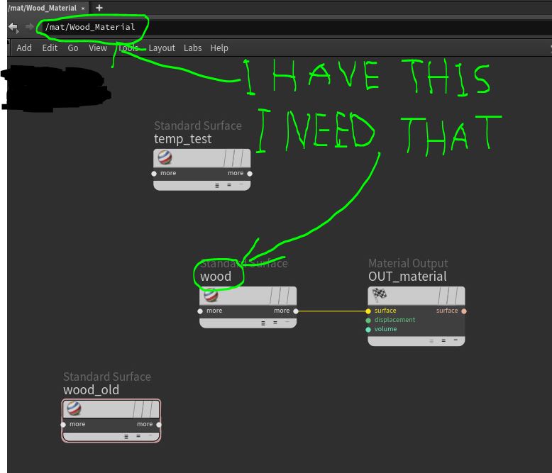

I'm working in sops but I need to fetch the name of multiple materials and use it in VEX. If I already know the path to the materials (like: /mat/Wood_Material), how can I get the name of the material connected to the material ouputs (always named OUT_material)?
I'm guessing it can't be done in VEX. If so, is there a way I could use a python sop that would get the info so I could then get it from a wrangle and continue in VEX?

This is a bit more hard-coded than I'd usually prefer, but it works as long as your material output is always name "OUT_material" and the material name you need is in the first input. Paste in in a Python SOP and connect it to your object. Running Python on each prim can be slow on bigger objects though.
It'll store the material node name in the prim attribute 'mat_name' which you can then access in VEX.
node = hou.pwd()
def GetMaterialName(node):
    geom = node.geometry()
    # Create the attribute to store name at first
    geom.addAttrib(hou.attribType.Prim, 'mat_name', 'None')
    for prim in geom.prims():
        matnode = hou.node(prim.attribValue('shop_materialpath'))
        mat_childs = matnode.children()
        for c in mat_childs:
            if c.name() == 'OUT_material':
                mat_name = c.input(0).name()
                prim.setAttribValue('mat_name', mat_name)
# Run the script
Edited by Tronotrond - Nov. 15, 2023 12:57:03

With your permission, I would improve this code a bit and just return the output of the subnetwork itself, so that the inner loop is avoided and it doesn't refer to a hard-coded name.
    mat_name = matnode.subnetOutputs()[0].input(0).name()
