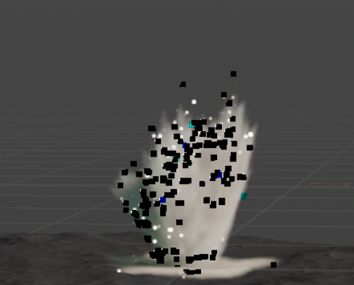

Hi, i have issue with using Cd and alpha channel to get multi color in my pyro.
i anabled color and alpha in my pyro burst and set them in solver source as blend, but i get this black flickers in beginning of my explosion, i even see them in render unless i give karama pyro material to it.
what is the problem? where am i wrong?

well, I've got my answer with more effort, i have to turn on 'color' in field tab in the solver. ( thanks, my yellow ducky )
