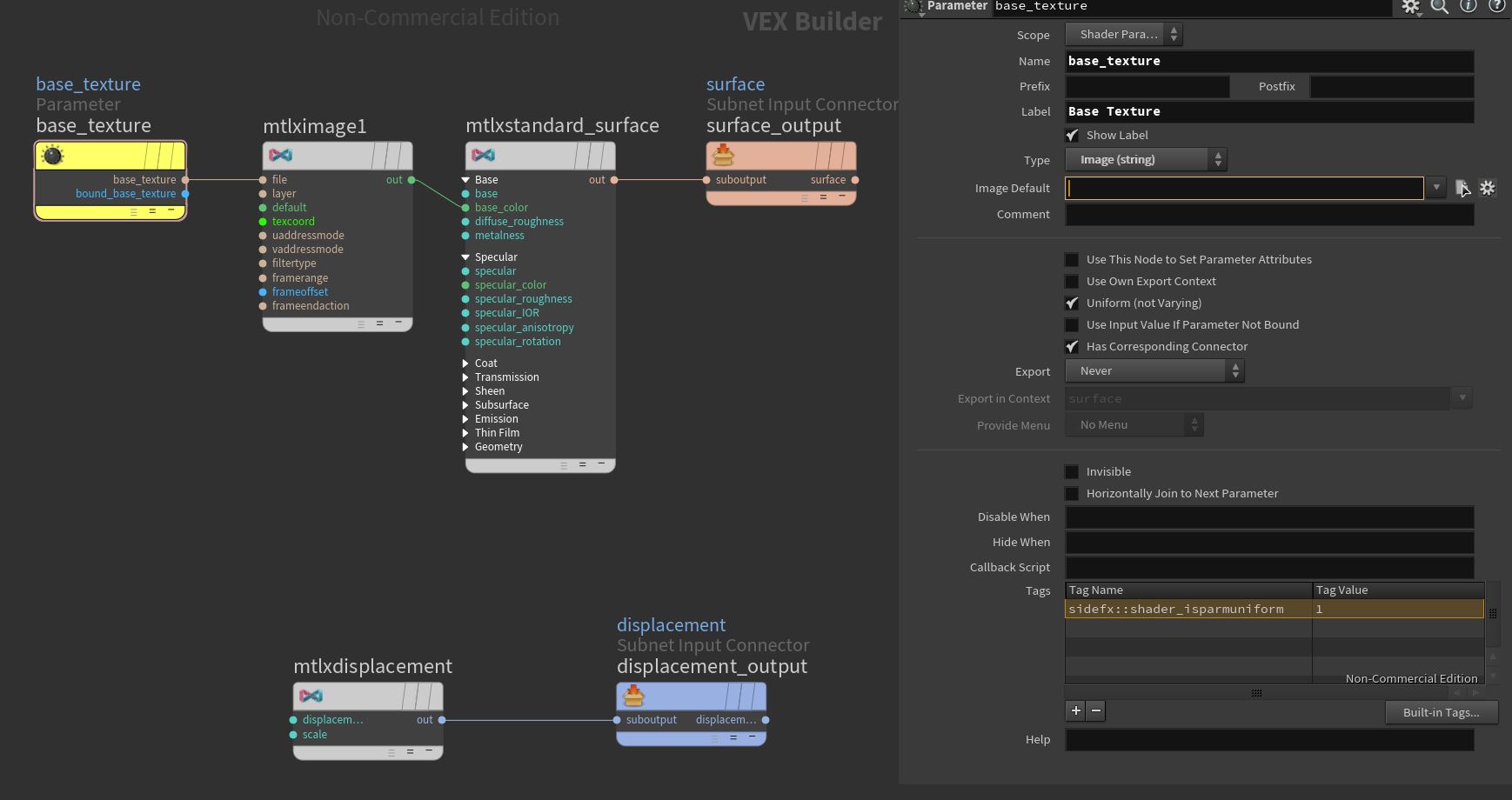

As far as I know in USD itself there's not really such a thing as cross-referencing between Shaders/Materials like a master material. In Houdini itself however, you can of course just create "reference copies" of Houdini nodes so they reference the parms of the others, except for those you want to tweak.
In USD with most renderers what you could do instead is putting down a node that reads a particular user data from a primvar on the geometry. E.g. you could read a filepath from a mesh attribute and use that for the texture, or use a float value from the mesh for specular - etc.
This works fine with Arnold materials. Quickly trying Materialx here with string values doesn't seem as trivial, see attached.
Maybe this gives you some ideas for general approaches.

USD allows you to export and reference (and later override) whatever scene description you want, so exporting a base material setup and referencing (or sublayering) that into multiple assets is a perfectly reasonable way to go. In theory the editmaterial lop should allow you to author sparse overrides (such as base_color) on top of the referenced base material. In practice the material editing workflow might not quite be there yet (I haven't tried myself in since Houdini 19).
Primvars are another way to go if you feel like its tractable to attach overrides as attributes to the geometry (or ancestors), but usually just overriding the actual material is more straightforward.
