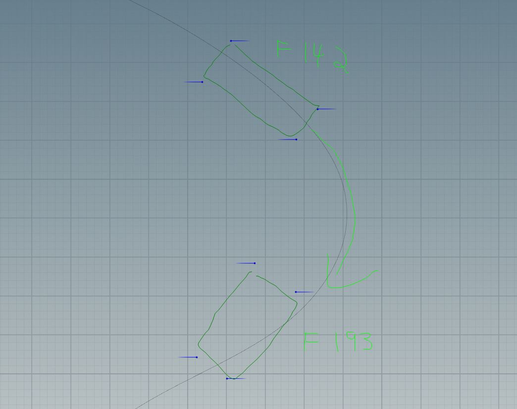

I was making a simple car setup. I created a point with v@N and v@up for each wheel (total of 4) with normals (left wheels point to the left, right wheels point to the right).
My goal was to use a copy-to-point to copy those 4 points to a single animated point (position, Normal and up is animated). When I do, the 4 point positions are perfectly moving and rotating but the Normals never changes.
In the image, you can see the problem. The car is going from top of the image to the bottom. The Normals are already wrong at frame 142 and they dont even rotate during the animation.
