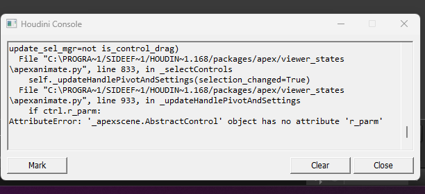

I checked out your file, and everything looks like it should, but there seems to be an issue with abstract controls in that file. Even when jumping into another geo node and creating a simple abstract control, I'm getting the same error message as I get within your setup -> "AttributeError: '_apexscene.AbstractControl' object has no attribute 'r_parm'"
I've attached a example file of a working blendshape setup, check and see if it works. But in terms of why your setup isn't working, I'm really not sure why the abstract controls aren't getting the 'r_parm' attribute. Could be a bug.
Hey Max, big fan of your tutorials. Anyways, the issue is actually fixed, I added SetPointAttribval node instead of primattribval. Funny how a small hidden thing completely breaks it huh?
. I also edited the original post but it didn't update for some reason (probably my bad internet connection).As for the r_parm bug, I am not getting that bug anywhere, so I don't really know what it means
