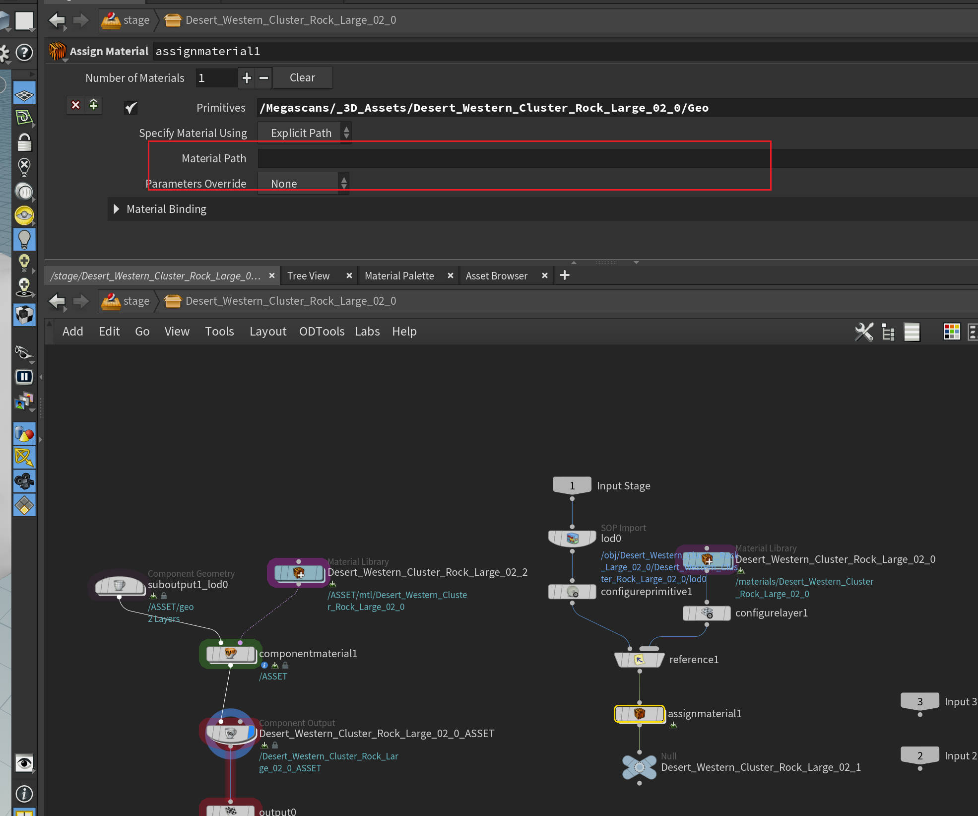

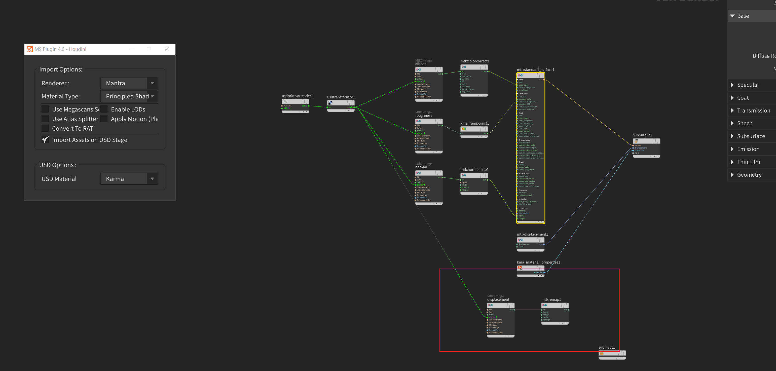

224 posts
still has some issules
Edited by wanglifu - June 30, 2024 18:40:16
28 posts
Joined: Jan. 2018
Yeah sorry I had disconnected that as it was causing visual issues in the older versions of houdini. I updated the code to connect them again. Also the old method should assign the material properly if you wanna use that.
Just download
MaterialsSetup/Karma.py
and
AssetImporters/Import3D.py
if you wanna just patch it.
