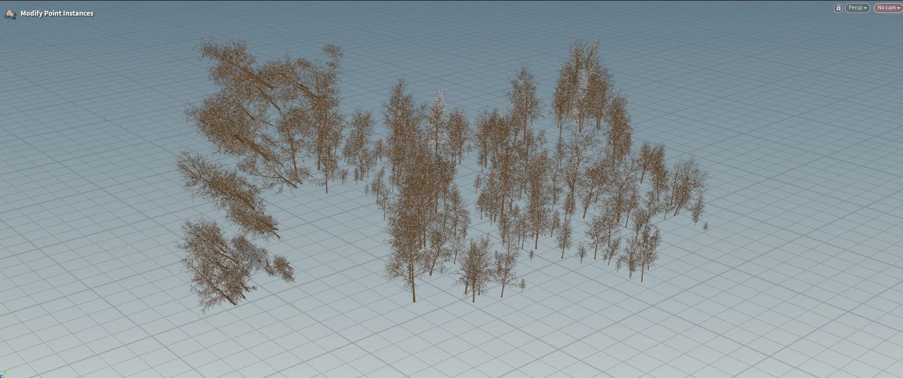

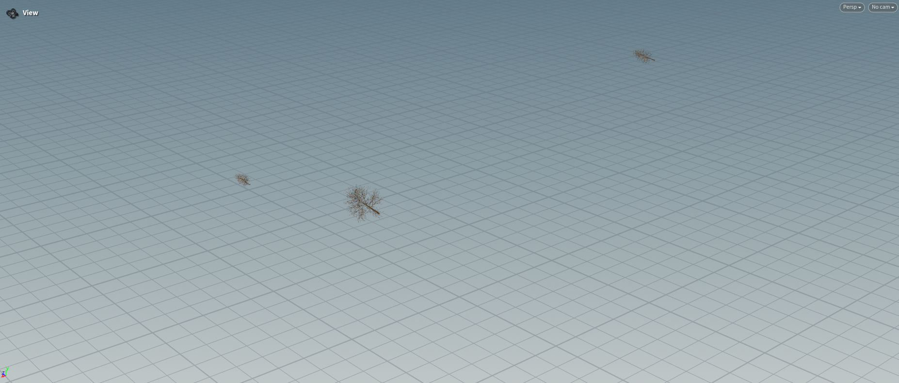

I am experiencing a weird behaviour on the Modify Point Instances Lop (modifypointinstances)
in Houdini 20.5 VS 20.0
The same USD file works as expected on H 20.0.653 and does not in H 20.5.332
Attached a few screenshots of the expected vs not behaviour.
Attached also an example hip of what im doing ( no usd provided )
Unfortunately I cannot provide the usd file as is part of production.
I am still trying to create a new USD test file that replicate the situation but so far no luck
Any pointers on what could cause this is highly appreciated. Thanks!
PS. seems like something is messing up the id matching which causes both the transformation and the deletion of the instances to fail
Edited by wlvl_r - April 24, 2025 12:07:14
example_hip.hip (452.1 KB)
