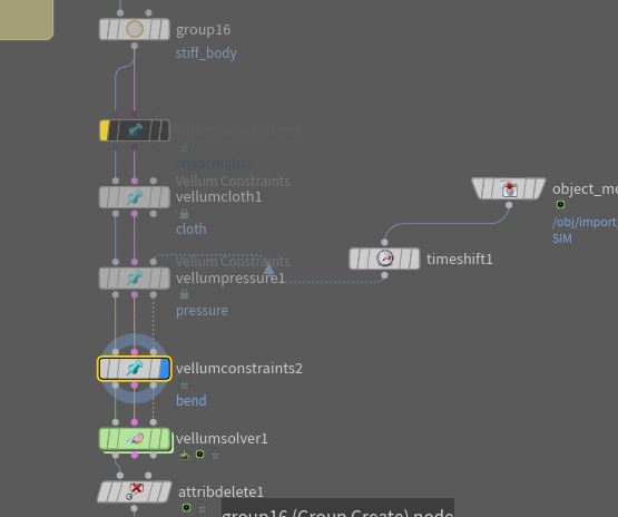

Everything works fine but I want the cloth/vellumPressure affect only the top part of the body.
I created a group and added Vellum Constraint to keep the original state of the mesh part from being affected however it's not working. The whole body is still being affected despite specifying the group.

I will attach some screenshots.

Hi Alexandra,
can you share the screenshot of your vellum constraint node parameters?
Also, i think you should be able to select the group on the vellum pressure node itself. Just select the group (chest area) which you want to apply pressure on and plug it in the vellum pressure node's group box.
hope this helps.
-Rohit
