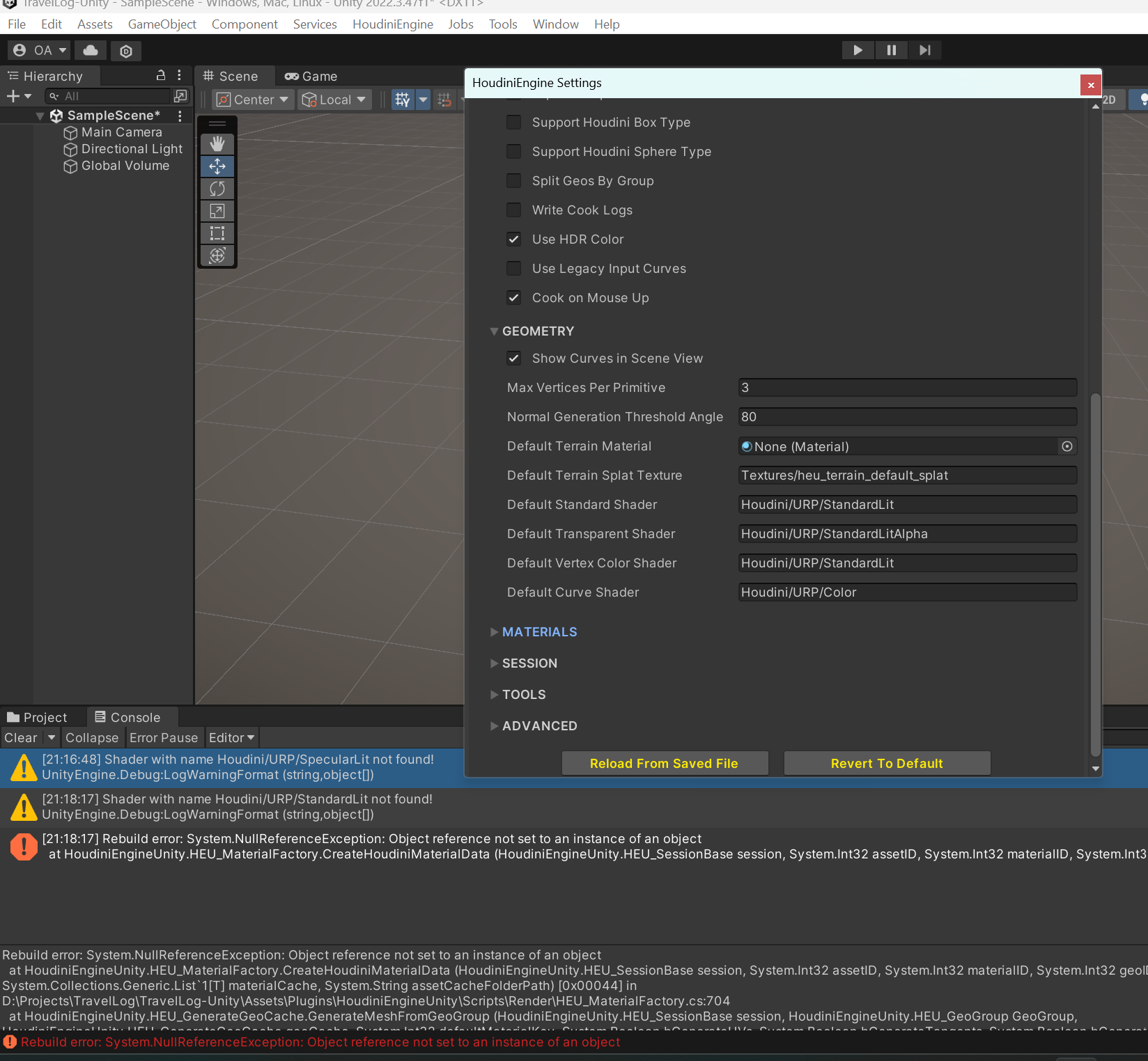

I'm trying to load an hda into a Unity URP project but get the following error: "Shader with name Houdini/URP/StandardLit not found!". I don't see any URP shaders included in the asset import - are these missing or am I missing an installation step somewhere? I've tried on existing projects and clean brand new projects and get the same issue. The SpecularLit shaders also seem to be missing, I get the error when I change to specular in HoudiniEngine --> Plugin Settings.
Houdini: 20.5.332
Houdini Engine: 7.0.2
Unity: 2022.3.47f1
URP shaders missing

Edit: Turns out that this issue was already fixed, everything works perfectly in 370.
Just as a follow-up to my initial post - I tried it with the latest 19.5 and the URP shaders are included in the Houdini Engine import, and the HDA loads in Unity without any errors. I have submitted a bug report.

Oluf AndrewsHello, I also brought this issue up earlier. Were you able to get the Unity plugin working perfectly on any Houdini version after 20.5.278?
