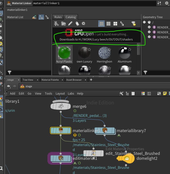

Unfortunately, if i save shaders inside $HIP structure it still required redownload shaders on another machine.
Catalog by itself tells i can't use $HIP for the path.
Catalog looks to the right directory but still complain for the shader and not render it untill redownload it
