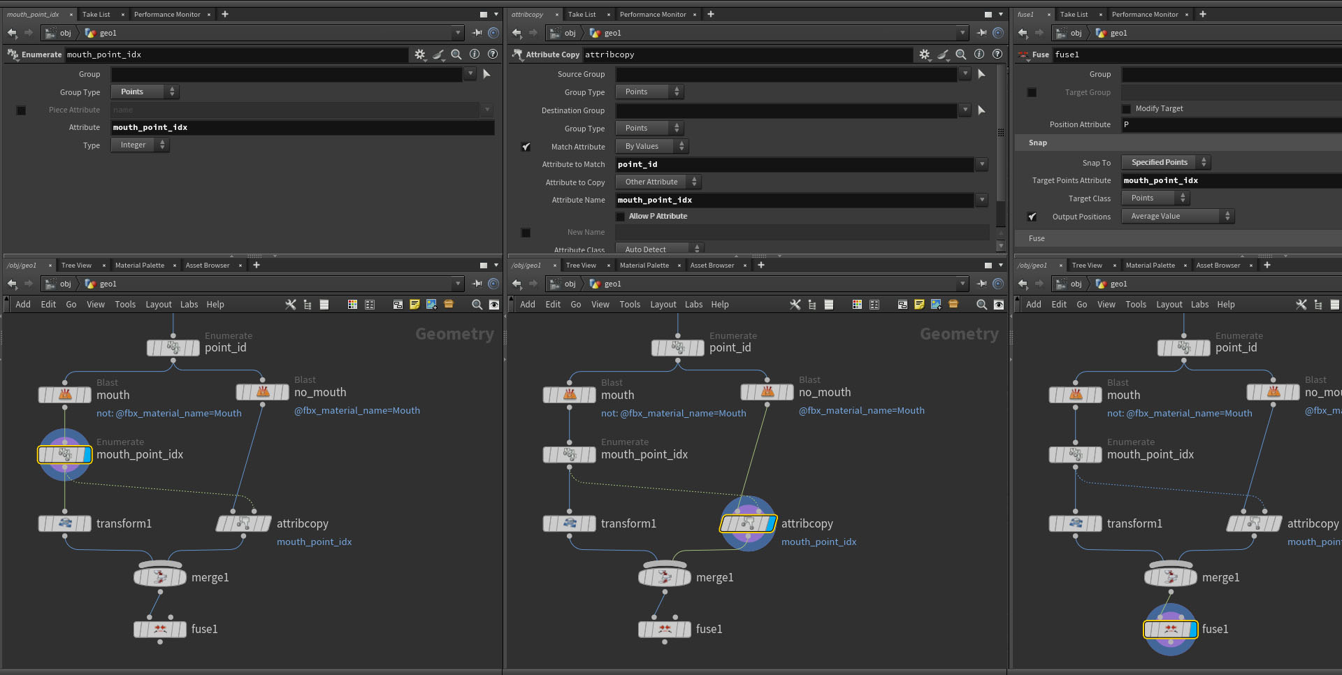

My goal in simple words is:
I have 2 models, one is A, one is B(target).
I need to wrap A to B, which will result in a model having A's topology and B's shape.
I blast the inner mouth part, so the wrapping process will leave out the inner mouth.
After the wrap, I want to move the inner mouth part(using point deform), to match B's position, without manually use the edit node(because the point deform is automatic, less manual adjustment is good).
But the problem is, if I merge, there will be extra points and it'll fail to create a blendshape

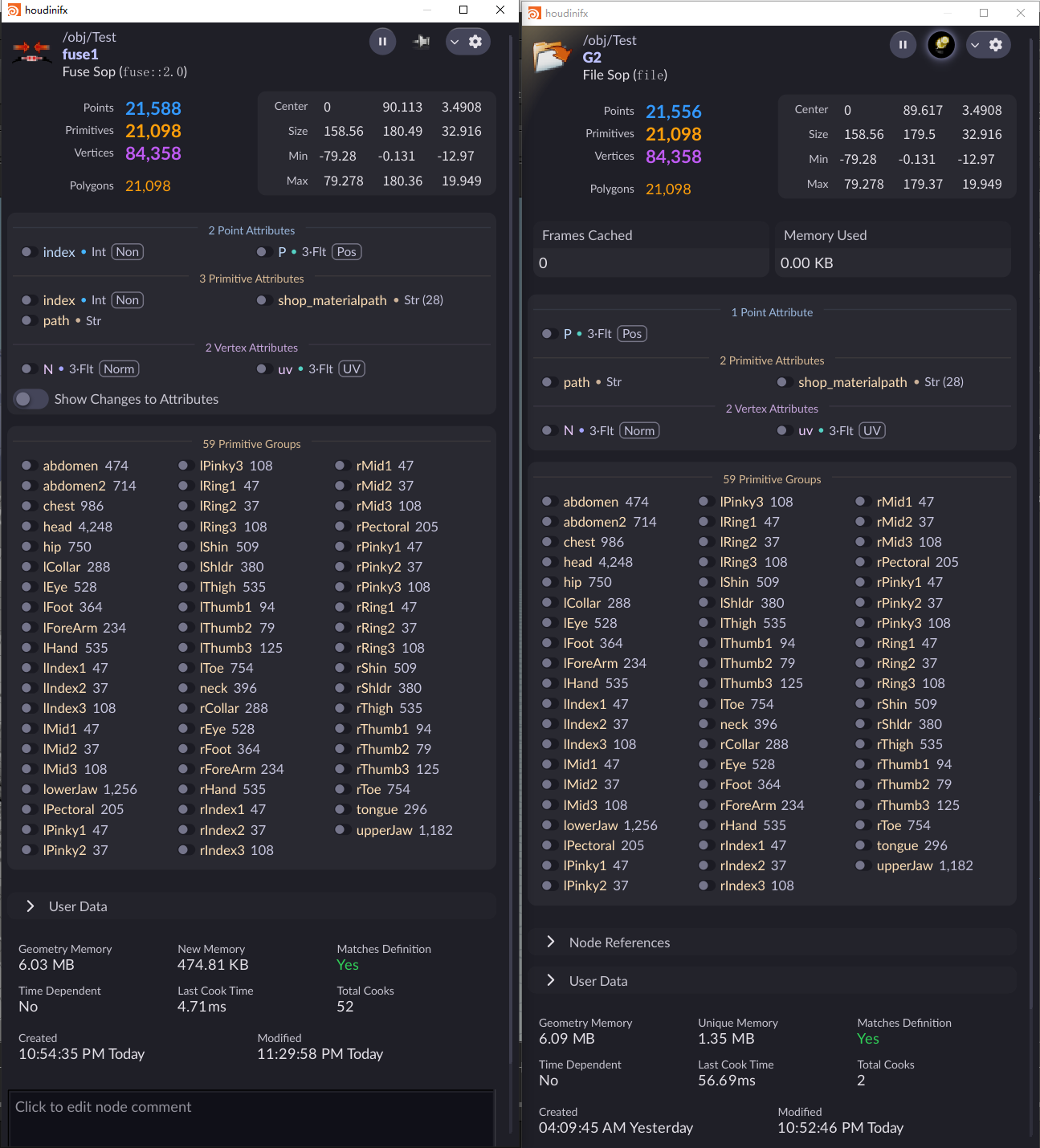

154 posts
Without seeing the geo I can only guess but if the "inner mouth" and the rest of the body are a continuous mesh then of course blasting a section will duplicate the points along the edges where the mesh was split.
Can you utilize the rigid primitives group on topotransfer? That way you don't have to separate the mouth and it should come along for the ride without being deformed. Then you can adjust it's placement after.
Joined: July 2017
You can get the results you want this way.
Edited by Neyl - Oct. 28, 2024 15:16:10
Screenshot (256).jpg (175.4 KB)
9719 posts
Joined: July 2007
You can also Point Deform the whole original A using your rest and deformed Geos without inner mouth instead of deforming just mouth
And if needed you can use different point deforms on different groups to have the outer part match exactly without smoothing or even post blend that part directly
7 posts
Joined: Feb. 2021
freshbaked
Yes the "inner mouth" part is onnected to the lips, I found out they share the same points, that's the reason.
Thanks for the advice! I don't really see too much of a difference between specifying the rigid primitives group and not, the result looks very familiar to me~
