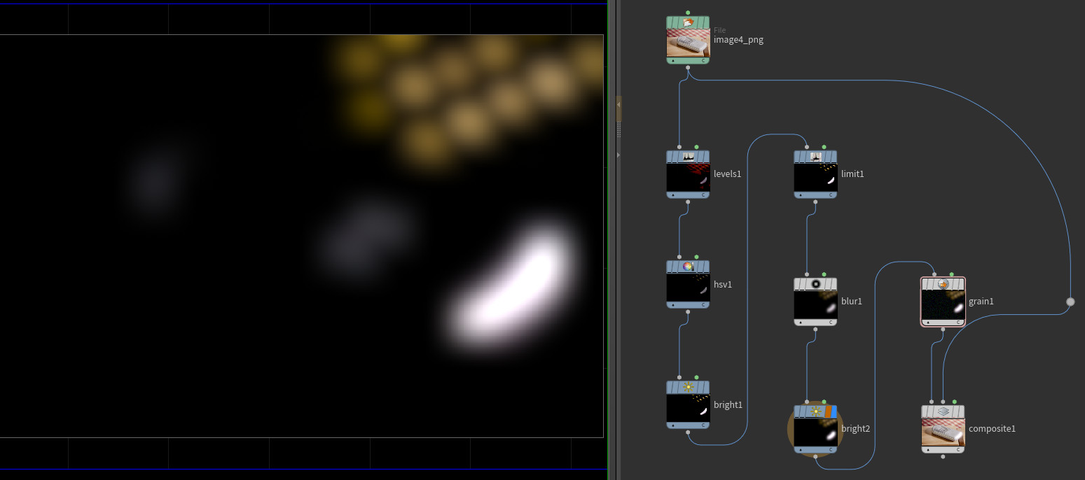

I see. Yes, it's a new Copernicus (COP) node introduced in 20.5.
Glow is basically a blur applied on a range of bright pixels. You can reproduce it with COP2s by isolating high pixel values, desaturating them slightly, blurring them, ramping up brightness, and comping the result back with the original plate (Screen or Add).
The attached image demonstrates a basic glow setup in COP2.
