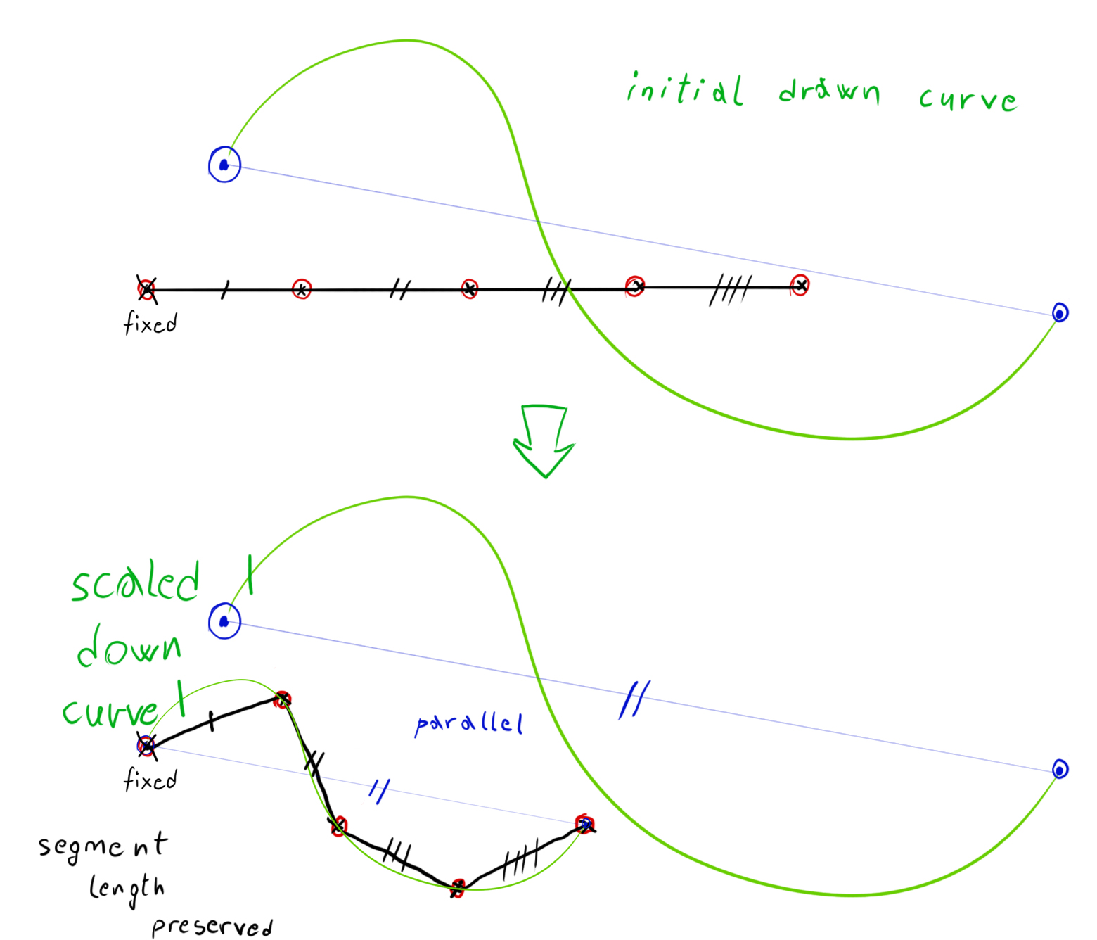

115 posts
I was having in mind something like this:
59 posts
Joined: Jan. 2017
citizen
ah I see! Yes that'd work for fixing to the start and preserving lengths, and it would keep the characteristics of the drawn curve if not the positions so there's definitely a use for this. I think there are situations where this could get frustrating (eg trying to get a character to scratch their own head, if we can't control the position of their hands at the other end of the joint chain), but maybe that's just where it would need an option to flip between preserving lengths or preserving positions.
