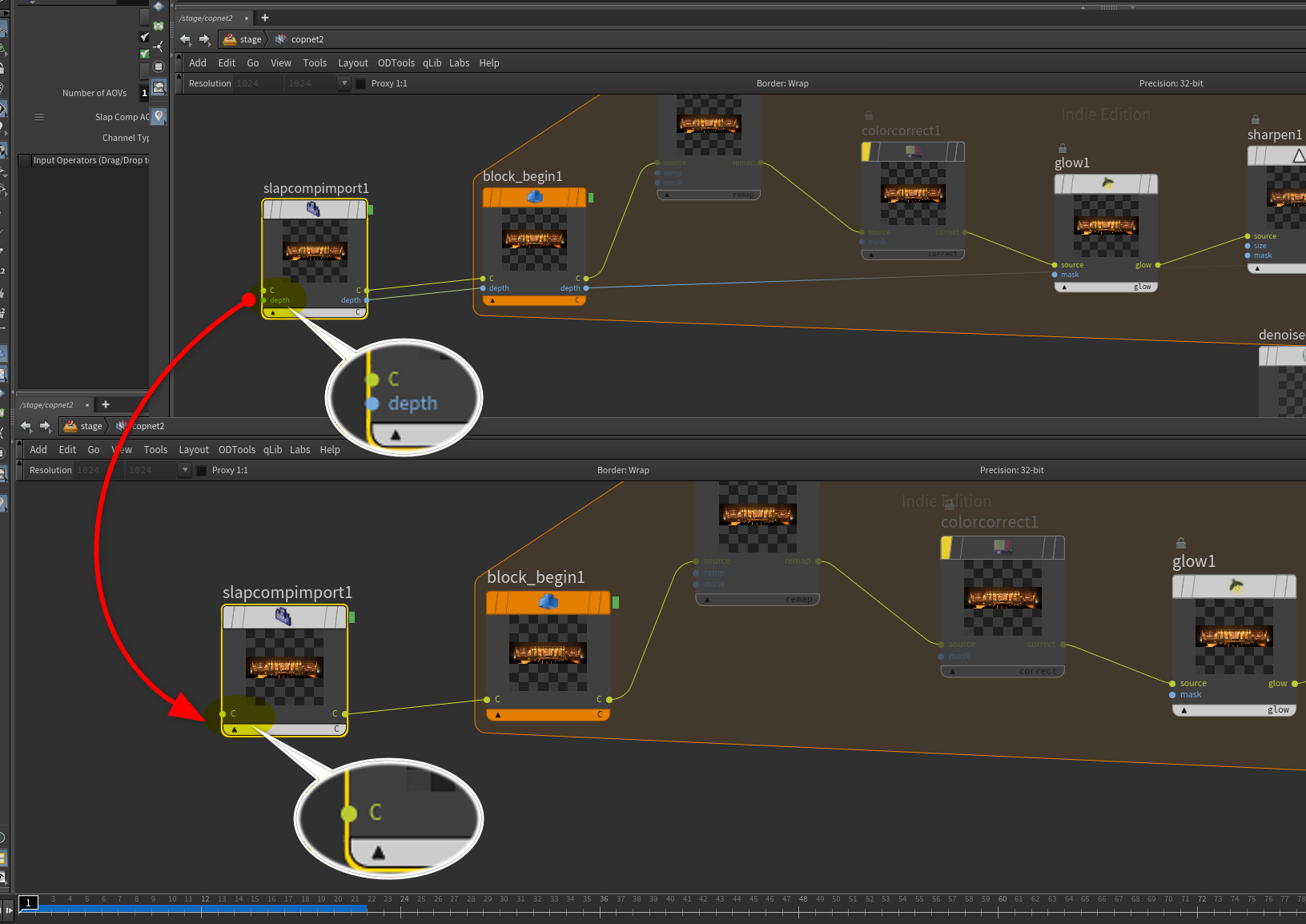

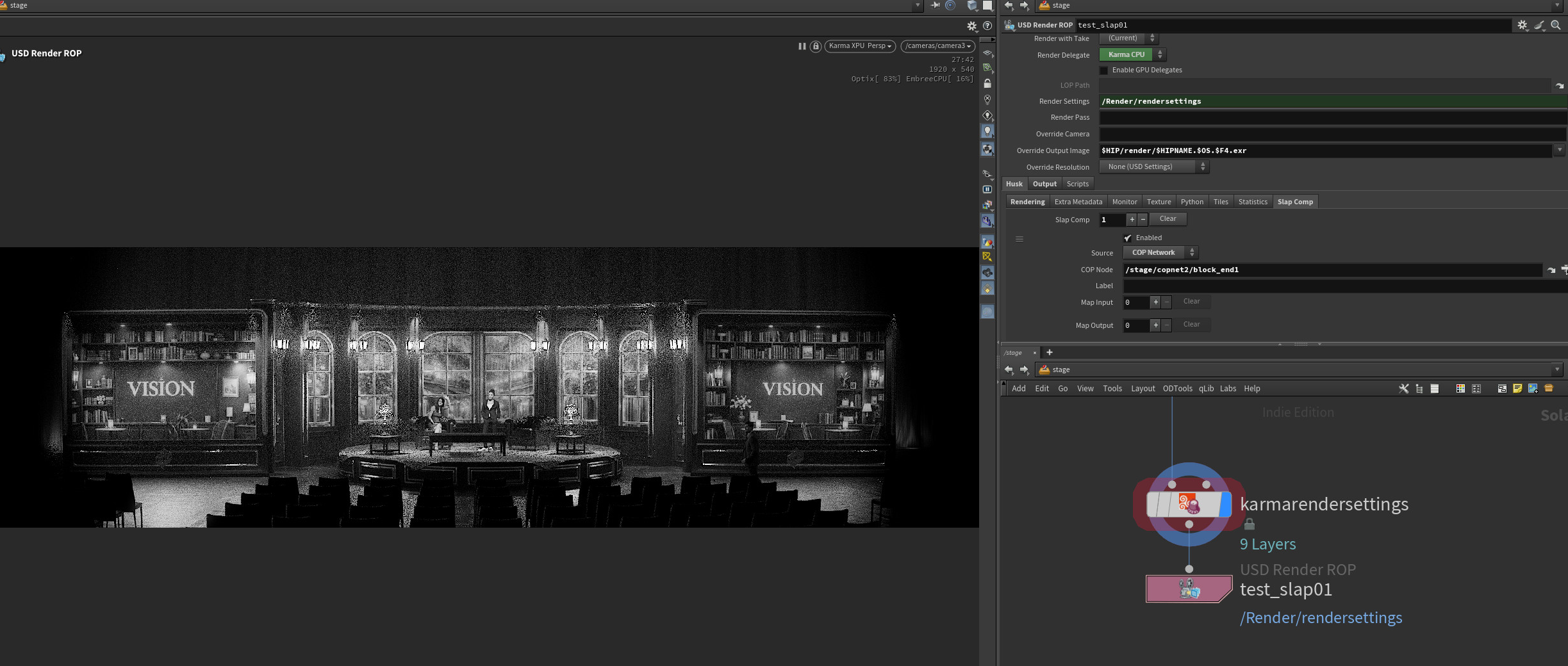

Hello, I setup the USD render rop / Husk / slapcomp and the render is not updated with the copnet filters..
Thanks for helping.
Edited by Sebastien Levieux - 2026年4月9日 15:28:58
72 posts
Joined: 11月 2014
I find the issue, I removed the the extra AOVs ( at the block end as well) and I kept only the C
