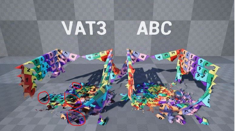

Ok thanks for your help. Here's an update on the cloth comparing VAT to Alembic, but I noticed that the reverse side is black/darker for VAT.
Edited by BagMan64 - 2021年9月22日 11:28:14

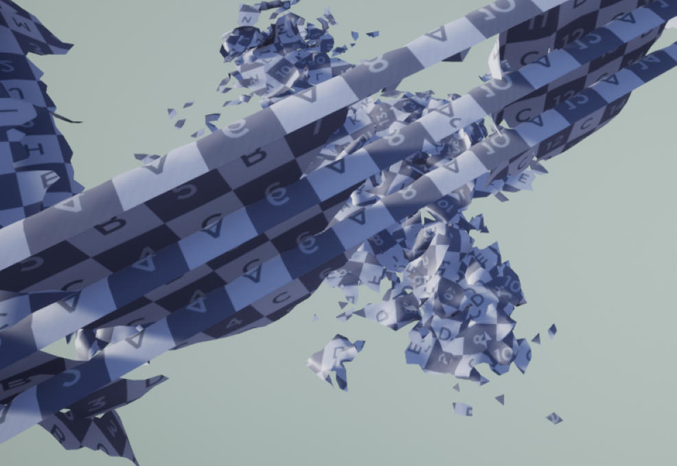

If you have turned Two Sided in the Material, please double check you have turned Two Sided Normals in the VAT Material Instance.
Off:
On:
