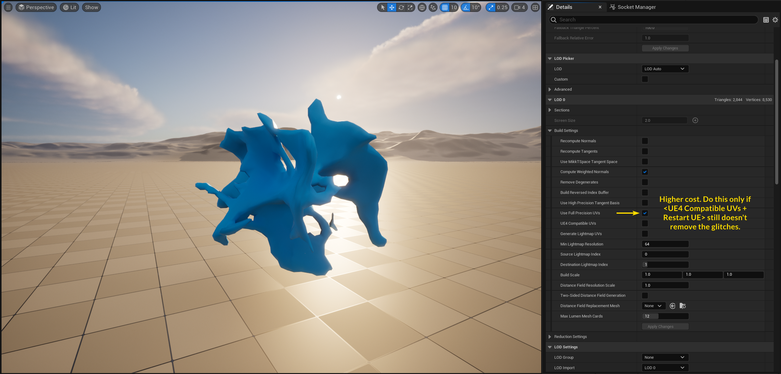

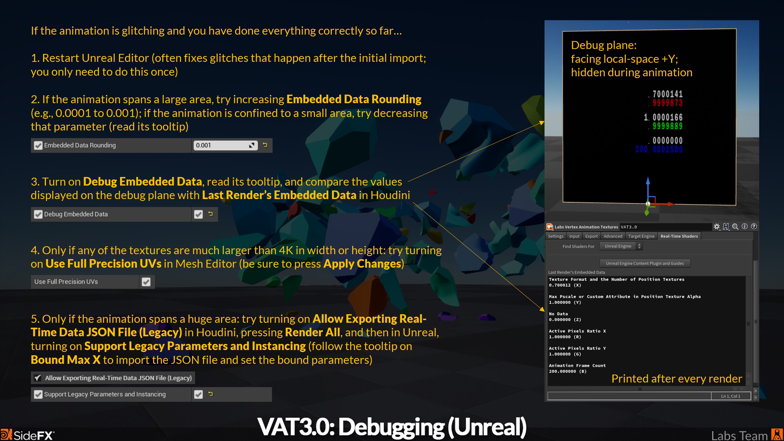

Q: My VAT in UE looks broken. What do I do?
Most often, the issues with VAT in UE4/5 (more on UE5 in the next question) can be resolved (or at least tracked down) by one of the following steps. If none of the steps identifies or fixes the problem, please don't hesitate to reach out to us at support@sidefx.com and submit it as a "question". We typically respond within a day or two to questions.
Q: Why is my VAT mesh full of holes in UE5?
UE5 changed some mesh UV implementations which can cause VAT mesh to look glitched. It happens often with the Dynamic Remeshing (Fluid) mode. To address this issue, you can simply go to UE5 Mesh Editor and turn on UE4 Compatible UVs. If that does not work even after you restart UE, try turning off UE4 Compatible UVs and turning on Use Full Precision UVs (which is somewhat more expensive, only use if absolutely necessary).

Joined: 5月 2016
Hi
I'm using VAT 3.0 to unreal 4.26. I can export normally fine, but when I've tried to export for use with Niagara mesh the mesh appears covered in holes. I've followed the guides on artstation accurately as far as I know so any pointers would be appreciated!
Edited by zampha - 2022年1月12日 12:42:57

Hi
Did you get a chance to try the debug steps? One possible solution, depending on the size of your texture, is to turn on Use Full Precision UVs.

Joined: 5月 2016
Thanks Mai, full precision UVs did the trick, thanks for the tip!
