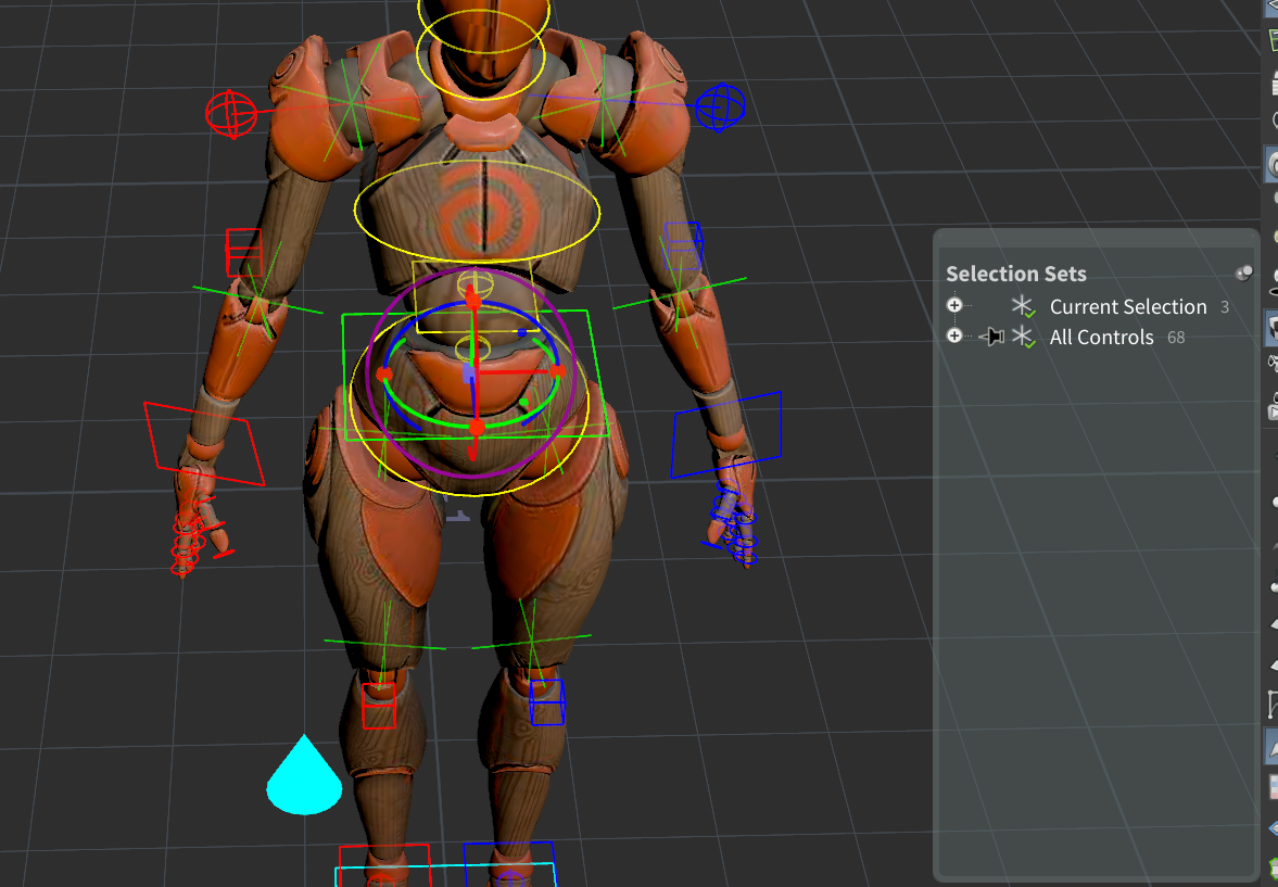

hey, messing around with this electra character and have couple of questions
1. is there a shortcut to cycle between aligment modes?
2. is there a way to change thickness of rig control helpers? they are quite big and cover a lot of screen
3. is there a way to hide / unhide controls? without deselecting sceneanimate1 node?
Zrzut ekranu 2023-11-09 093339.png (667.2 KB)

Hey TomaszD
1- use ctrl+g and it brings up a hud to select alignments and some other options
2- I think they are built into the rig like that (use selection sets to hide if needed)
3- for displaying characters and controls, use the selection sets and you can set up sets that you want to hide/show

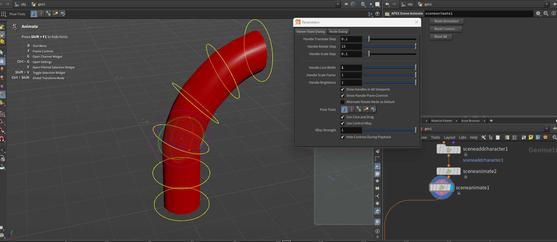

Joined: 4月 2015
Mirko Jankovic
Yes controls are definitely too thick "_
well with a bit here and there u can make them looking somehow usefull
1. using own shape controls helps get rid of that fat thing
2. messing with parameters for viewer stage dialog (press P in viewport while scene animate node is active)
in my opinion, this should be the default display setup for everybody
Edited by sadaih - 2023年11月10日 17:07:22
