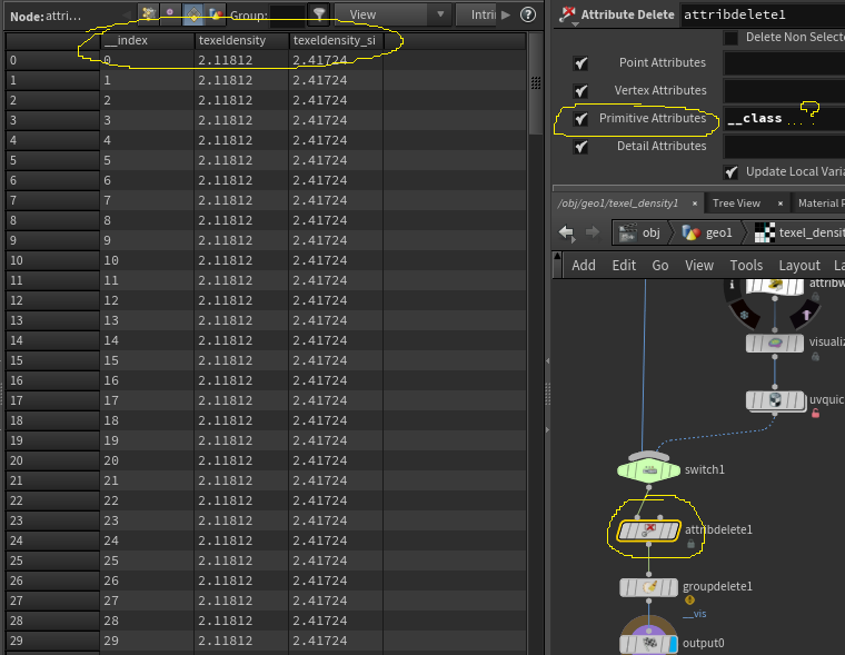

I figgered it out in the meantime.
I was using the labs texel density node to keep my UVs consistent in size, and it turns out that that node creates some additional primitive attributes. It seems that adding additional primitive attributes messes with Maya's material assignments. My guess is that adding primitive attributes changes the index where Maya was previously looking for the shader group attribute.
To illustrate:
Maya mesh goes in with attribute 1, and attribute 2. Maya knows that the first entry is the shader group. The HDA adds another primitive attribute on front of the stack. The mesh coming out has attribute 1, attribute 2, and attribute 3. Attribute 1 is the new attribute, and attribute 2 is now the shader group, and attribute 3 is former attribute 2. Maya is confused because attribute 1 no longer has any shader group info.
I'm not a programmer, so perhaps someone will be able to explain it more accurately than I.
Dilemma solved.
