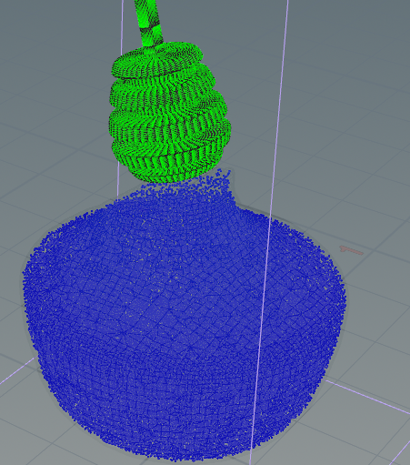

Hello, I would like to make an animation with honey and spoon. The spoon goes up and the honey flows down. But no matter what I do, the honey does not stick to the spoon, but remains more like hard honey, i.e. rigid. If I add more density, it becomes watery. I don't think the honey itself is the problem, but the spoon. I don't know what to do.

I remember seeing an option for sticking in FLIP:
On the FLIP solver, you can make the fluid cling more to collision objects by turning on Sticky fluid in the Volume Motion ▸ Projection sub-tab.
From: https://www.sidefx.com/docs/houdini/fluid/tips.html [www.sidefx.com]
