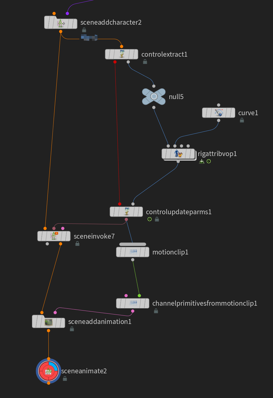

I want to have a path animation first, then add some animation onto it.So in sceneanimate2 node,I add an animation Layer,and Clip name on sceneaddanimation I set to "anim1".Here's the problem.I would change path(curve) during keying,but animation is not updated when I modify the path,I found if I change Clip Name on sceneaddanimation("anim2") ,the path animation update.In rig tree there is "anim1" "anim2".But in my new animation Layer,I can't modify my animation curve,it says:

8161 posts
It's currently not possible in H20.5 to propagate animation across multiple nodes. The APEX Scene Animate makes a copy of the input animation and will store it inside the node. So if you change the animation upstream, it won't propagate downstream.
