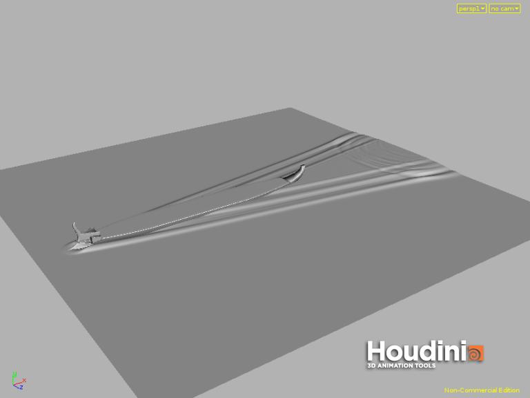

1 - How do I stop a ripple DOP from having the ripples bounce off the edge of the geo? I want them to continue on like the grid I am using was infinite.
2 - Also, can anyone confirm that the “use deforming rest” actually works? I have two DOP networks, both identical except that one has “use deforming rest” on, but the results are identical, even though my rest position geo is animated. I attach a file… toggle the “use deforming rest” on and off and there will be no difference. H9.0.768
3 - Basically, I'm trying to do a boat wake and bow wave, with little success. Anyone had any luck doing a 2d fluid sim? (The ripple DOP will only do the bow wake, I haven't even got close on the bow wake.)

Deforming rest works. The Rest SOP Path needs to point to /obj/grid_object1/rest1 and the Initial SOP to /obj/grid_object/grid1. This is opposite to your attached file. If I reverse those and turn on deforming rest, it works.
Note that changing the rest geometry creates a sort of fluid potential rather than an actual fluid motion. Another approach to collisions is to use the Ray SOP to displace the actual grid geometry inside a SOP solver. Attached is such an example.
- jlait
- 6956 posts
The best answer I've got to the open end conditions is to paint a region of dissipation around the boundary. The attached example shows this in action.
There is still reflections occurring whenever the dissipation steps up, but by spreading the reflection over several points on the grid they will cancel each other out and the wave will disappear.

To avoid the reflected wave you can paint a lower dissipation along the boundary. In 9.1 and later the dissipation has been renamed to the more correct “conservation”. Earlier in this thread is an example file of using dissipation to dampen the boundary conditions.
Setting a dissipation/conservation to 0.95 or similar across the entire grid will likewise cause the waves to fade out.
