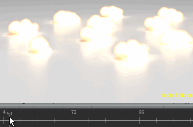

There is a way to set that up in LOPs, but this older approach from /obj and /out still works.
