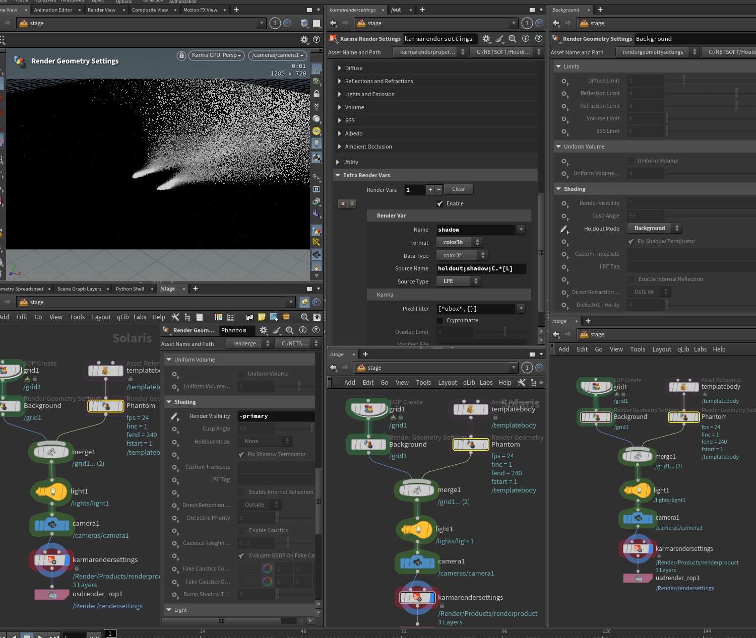

Hi!
you can use LPE: holdout;shadow;C.*<L.'domelight1'>
to make it works in Render Geometry Settings switch Holdout Mode to Matte or Background.
"C" avoids shadow reflections.
"<L.'..'>" split LPE tags
You can also make shadow casting geometry phantom

In mantra you can build specific shader using shadowmatte node, depending of compose task bind it to AOV or render as beauty. unfortunately I don't imagine way to avoid beauty calculating.
In Karma use render geometry settings node to set shading properties, type LPE exp and it will be enough. This way is faster because beauty might not being rendering.
