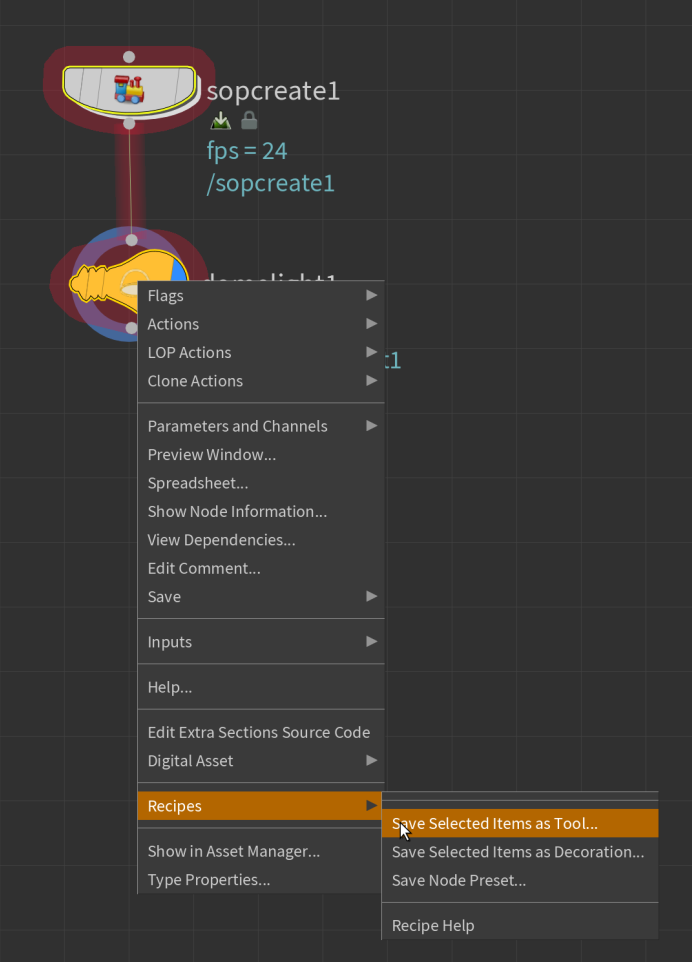

I have a simple node setup. I select both nodes and right click. The recipe menu appears as expected. If I use a network box around the nodes and then select all, the right click doesn't show the recipe menu as before so I can't save as a recipe. According to the documentation, network boxes are supposed to be included unless explicitly excluded from the save recipe menu. Am I missing something here?

Looks like you just need to right-click one of the nodes instead, as the network box does not have the same menu available.

Hmm. When I select all three and and then right click over one of the nodes, I get the menu and when I select the option to create a tool I get an error

280 posts
Joined: Feb. 2016
Works here - in 21.0.490

I did some testing and found out that my first attempts to create a recipe inadvertently included a sticky note, which caused the error. So, I can create a recipe that includes a network box, but if there is a sticky note in the box, the following error pops up:
It would be nice if that was not the case because I want to use sticky notes to explain the use of the recipe.

You should submit this as a bug [www.sidefx.com].
380 posts
Fixed in version 21.0.490 I believe.
280 posts
Joined: Feb. 2016
Indeed, works well in 21.0.491
