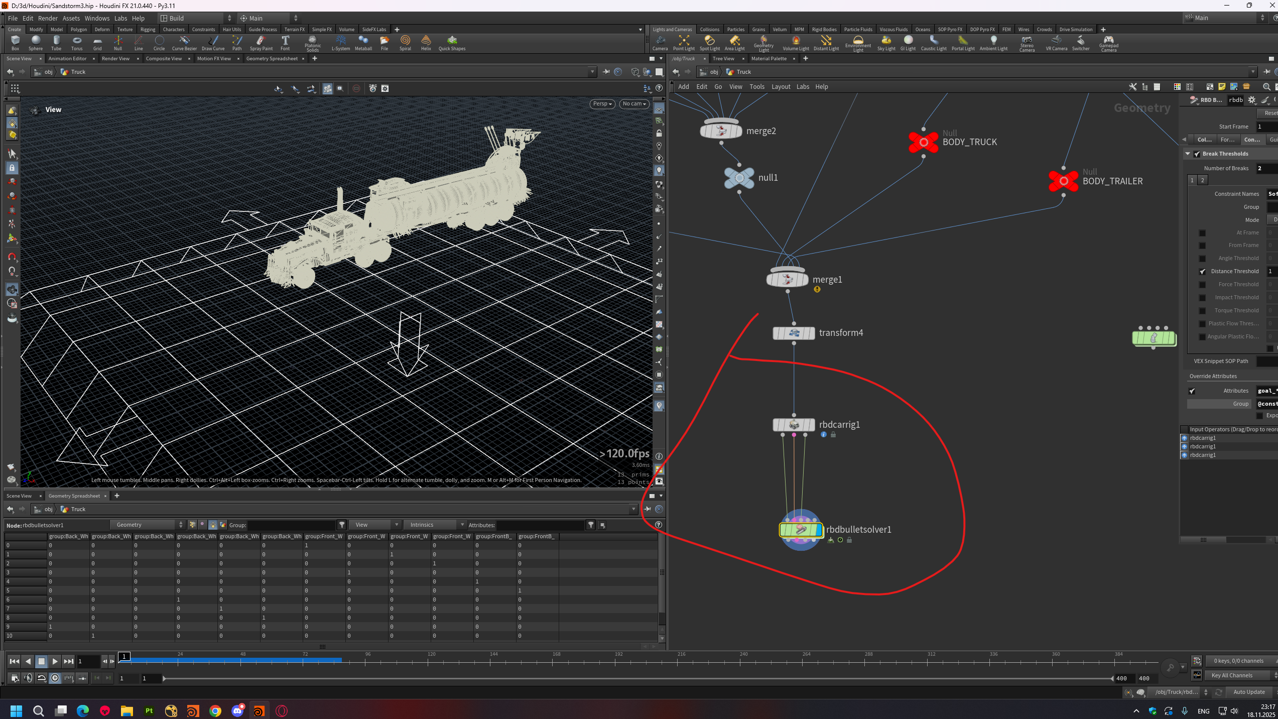

I need some help. I created a truck rig using the Carrig node, and now I want to add a constraint that connects the truck and the trailer. What’s the proper way to set this up so that the Carrig rig constraints work together with the truck–trailer constraint?
Is it possible to rig a trailer using the Car Rig node?
Right now, if I apply the Car Rig to the truck, and following your instructions everything works fine — but the trailer ends up with no wheels. And if I try to rig the truck and the trailer as one object, the AutoRig treats everything as a single mesh, which breaks the setup.
What I’m trying to do is:
rig the truck and the trailer separately
keep the wheels working on both
make the trailer automatically follow the truck and turn realistically (like an actual semi-trailer)
Is there any way to combine setups or maybe tweak something inside the AutoRig so it supports a trailer?
Manually rigging the entire trailer would be pretty painful, so I’m hoping there’s a better solution.

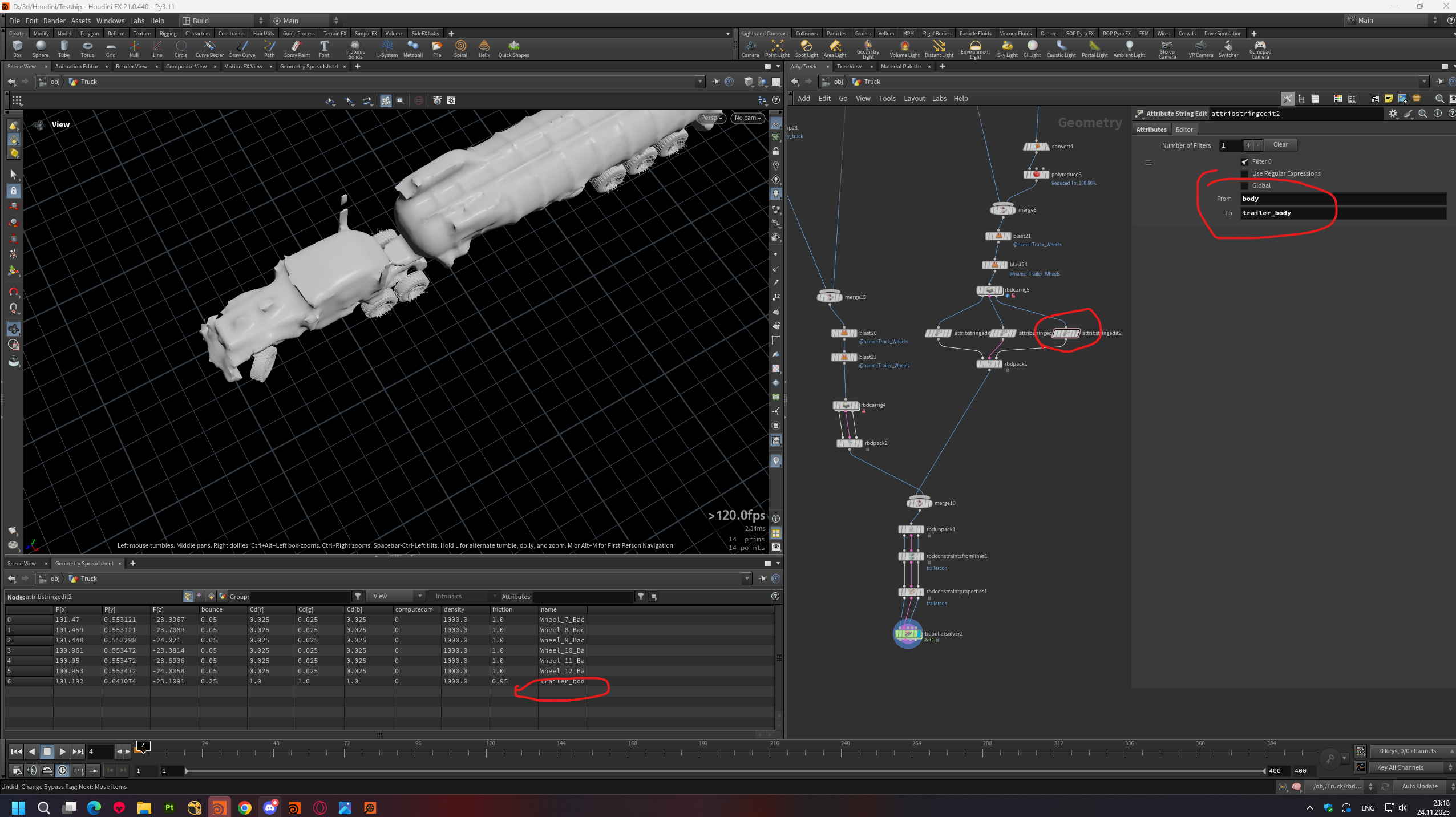

Yes you are right I found the solution yesterday The whole point is that the Car Rig assigns the attribute name = body to any object you rig. Therefore, we simply use the Attribute String Edit node to rename all the geometry and constraint primitives, as shown in the screenshot, and everything works.
