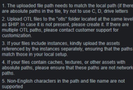

I need to change all my project paths based on $HIP in Houdini 20.5 . I need that to render in Fox Render (a virtual farm render).
In orders words i need to change this : C:/Users/TuUsuario/Proyectos/Houdini/escena/
To this: $HIP/geo/cache.bgeo.sc
Is there a specific tutorial to do that? I have already seen videos, but i didn't understand what i should do.
58fd7e2c-4b8f-4a9a-ac1b-373ad50f31cf (1).jfif (29.3 KB)

$HIP is the variable for the folder where your scene file is located.
So if your scene file is here:
C:/MyProject/MysceneFile.hip
Your cache needs to be here:
C:/MyProject/geo/cache.bgeo.sc
Now you can use:
And now the cache can be found on another system, too.
As long as the scene file and cache keep this relation.
