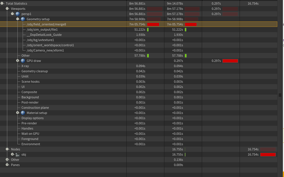

I am working in a scene with a ground fracture simulation that has around 15k packed geo primitives in it, and the viewport performance has become so bad the scene is impossible to work with.
With Vulkan enabled, switching contexts or changing the active geometry in SOPs will cause Houdini to stop responding with ~10% of the CPU cooking for 5+ minutes. ESC key does not recover the session, and no info is printed in the bottom console bar, so this does not seem to be related to cooking.
In OpenCL mode, the viewport behaves as expected even with the number of objects (performance monitor specifies any delay is due to cooking).
