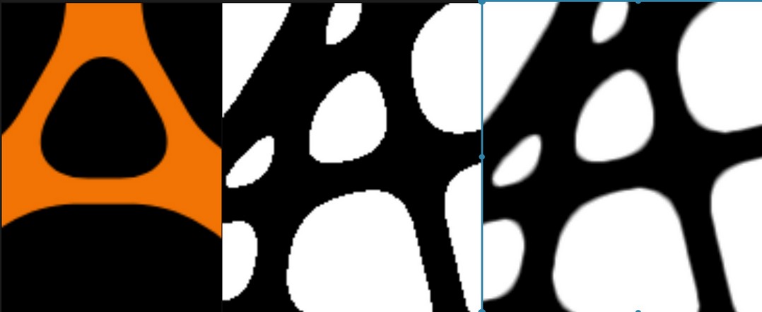

I attached a screenshot from an example I just made – the same resolution files and the same 150x150 pixel cutout to demonstrate anti-aliasing. The orange one is from Cavalry – perfect. The second is rasterization in COP. It moves terribly during animation. The third is manual "anti-aliasing". Blur + remap + one iteration of dilate/erode worked best. But this is only suitable for black and white. My intuition tells me that I could probably play around with the edge search, but the added complexity seems unjustified.
